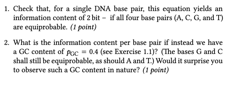

Calculate the information content of a DNA base pair
##I(A)=-\sum\limits_{x=A}^{}P_xlog_2(P_x)##
Unfortunately, I have problems with the following task
For task 1, I proceeded as follows. Since the four bases have the same probability, this is ##P=\frac{1}{4}## I then simply used this probability in the formula for the Shannon entropy:
$$I=-\frac{1}{4}log_2(\frac{1}{4})-\frac{1}{4}log_2(\frac{1}{4})-\frac{1}{4}log_2(\frac{1}{4})-\frac{1}{4}log_2(\frac{1}{4})=2$$
Unfortunately, I am not quite sure about task 2, but a GC content indicates how high the proportion of GC is in the DNA, so it means that AT must be present at 60 % and GC at 40 %. Is the calculation then as follows:
$$I=-0.4log_2(0.4)-0.4log_2(0.4)-0.6log_2(0.6)-0.6log_2(0.6)=1.94$$

Not familiar with the topic but if the formula in 'Relevant Equations' is correct then, for task 2, the four probabilties should presumably be:
P(G) = 0.2 (i.e. not 0.4)
P(C) = 0.2 (i.e. not 0.4)
P(A) = 0.3 (i.e. not 0.6)
P(T) = 0.3 (i.e. not 0.6)
(They have to add-up to 1.)
Not sure I understand the first question. It lists A, C, G and T as the four "base pairs". No, they are bases, the pairs being GC, AT.
But treating it as a matter of base pairs would yield ##-\frac 12\ln(\frac 12)-\frac 12\ln(\frac 12)=1##.
The question ought to read "for a single DNA base" (i.e., per base in a single strand).
This may be what fooled you into using 0.4 and 0.6 instead of 0.2 and 0.3 in the second question. But note that we can only get 0.2 and 0.3 by assuming that the orientations of the base pairs (which base is in which strand) are independent. One could imagine some sort of autocorrelation instead.

Thank you Steve4Physics and haruspex for your help 👍, I had completely forgotten that the 0.4 was for the pair and not one base alone.
