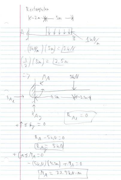

yes and no. it depends on what shape the UDL is. is it a rectangular shape? then yes, the UDL "acts" at the midpoint of the UDL. however, if the UDL is the shape of let's say a triangle, it "acts" 1/3 of the distance from the bigger end of the triangle. the SUM of all the forces in the y direction will equal zero, the SUM of all the forces in the x direction will equal zero, and the SUM of all the moments about a POINT will equal zero.
basically for a UDL, you find the area of the UDL, then that number is the total force it is inducing on the structure. You just have to find where its acting as a point load, then take the distance from where its acting to the point you're using as a reference (sum of moments about a point = 0) and multiply distance * force = moment. make sure you include all forces in the summations.
its easier if i just draw this real quick. here's an example of calculating the reactions of a fixed end cantilever beam with JUST a UDL. i won't do your work for you, but if you calculate your reactions and post back here ill help more.
