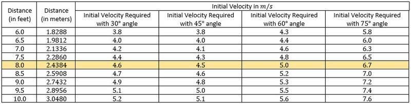

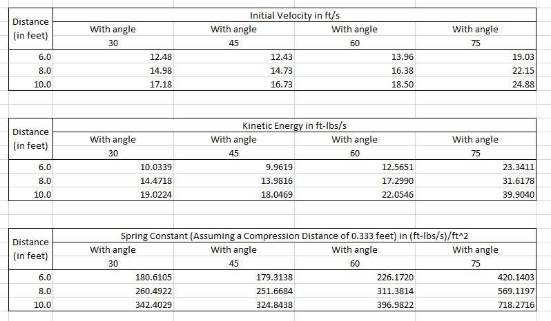

I'm working on a little ball launcher project where I have to launch a tennis ball 6 to 10 feet. (No more, no less.) I made a spreadsheet to help me quickly try different distance values at different angles. (I know 45 degrees is optimal, but I wanted the flexibility of trying different angles.) The spreadsheet helps me find the required initial velocity. Here are the values I came up with for the required initial velocity:
The design I'm using is essentially a crossbow. The ball will be placed in a chair. The chair will be pulled back by a spring that, when released, will accelerate the ball up an incline and lob it the required distance.
My question is... how do I use what I know (which is the initial velocity required) to calculate the required force constant of a spring? And from there, how do I calculate how far back the spring needs to be pulled? And finally, how do I then determine what kind of motor I need which will have enough torque to be able to pull back the spring?
Your spring needs to store all of the energy to be imparted to the projectile, plus enough to make up for friction losses in the system. For a simple linear spring, the stored energy is V = (1/2)K*delta^2 where delta is the deflection and K is the spring constant. For a nonlinear spring, find the stored energy by integration.
There are also matters of how fast you want to release that stored energy and this connects to the cocked displacement you need. It is a systems problem, not necessarily something that has a unique answer.
I looked up the kinetic energy formula online and found that KE=(1/2)mv^2 where m is the mass of the object and v is its velocity. I know the mass of a tennis ball is 58.5 grams (or 0.0585 kg), and I found the velocity already. So that allows me to calculate the Kinetic Energy (in Joules) pretty easily.
So now that I have the energy requirement ... can I use this equation (below) to find the distance that the Spring would need to be compressed? (Let's assume I buy a spring off the shelf which has a given force constant.)
U=(1/2)kx^2 where x is the distance the spring will be compressed, U is the potential energy (which equals the kinetic energy from the table above), and k is the force constant supplied by the spring manufacturer.
So to find the distance the spring would need to be compressed, I rearrange the equation for the unknown: x=sqrt(2U/k)
Is this valid? I'm not terribly familiar with these equations so I'm just basing this on what I'm finding online.
This is valid, except that you have not accounted for losses and you have assumed a linear spring. The crossbow you spoke of is probably not a linear spring. I'd do some checking on that before going too far.

Correct. It will land on grass, so I am assuming the distance it will roll will be minimal. Targeting the center (8 feet) should minimize the risk of rolling out of bounds one way or the other. That is also why I'm calculating different angles. While 45 degrees is optimal in terms of getting the most distance with the least amount of energy, it may introduce too much horizontal velocity. So that's why I'm going up to 75 degrees in the angle.
I don't really know what kind of Spring Constant I would be looking for ... so if I assume a compression distance of 4 inches (0.1016 m) (which seems reasonable, I think?), do these values appear valid for the required Spring Constant?
k=(2U)/(x^2) where x=0.1016m and U= the various KE values in the previous table.
So for example, 8 feet at an angle of 45 degrees would be =(2*0.5886)/(0.1016^2) is approximately = to 114.04

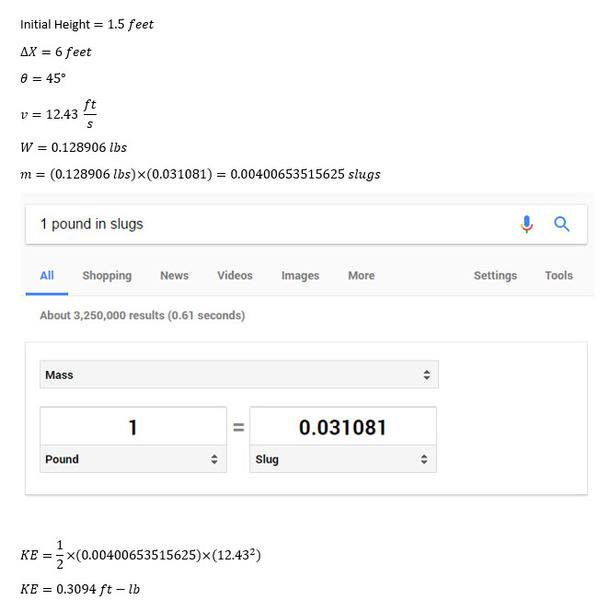

You said earlier that M = 58.5 gm, which translates to
W = 58.5/1000*0.4535924 [=] gm*(lb/gm)
= 2,653516*10^(-2) lb
and
M = W/g
= 2.653516*10^(-2)/(12*32.174)
= 6.872826*10^(-5) lb-s^2/in (if I have done all the arithmetic correctly!).
This is the value to be used in any kinetic energy or F = M*a calculations if US Customary units are used.

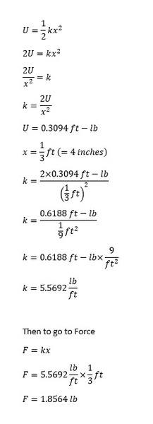

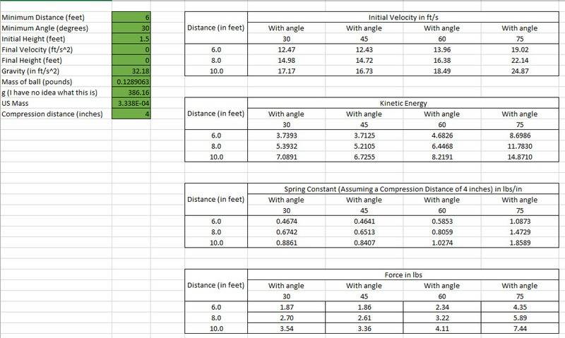

I made a copy of the sheet I was working on and tried to convert it all to feet and pounds. (Condensed the format a bit for simplicity.) The Initial Velocity in ft/s seems right to me. (And a quick google conversion agrees.) What about the Kinetic Energy and Spring Constant tables?
If you work in USC with length in feet, the energy will be in ft-lb and the spring constant will be in lb/ft.
If you work in USC with length in inches, the energy will be in in-lb and the spring constant will be in lb/in.

Hmm... I can't follow how the units cancel to get to ft-lb for energy.
For 45°:
If W = .0585kg *2.205 = .129 lbs
US mass = W/g = .129/386.16 = 3.34E-04
KE = .5 m v^2 =.5 * 3.34E-04 * 177.165 (in/sec) ^2 = 5.241
KE = PE sprg = 1/2 k x^2
k = 2 * KE / x^2
For x =4 in:
k = 2 * 5.241 / 16 = 0.655 lb/in
F = k * x = .655 * 4 = 2.62 lb
PS in US units my tennis ball weights 2 oz = .125 lb
If you work in USC with length in feet, then mass is in slugs = lb-s^2/ft. You did your calculation with weight rather than mass. This is a common mistake, but it will consistently get wrong results.
This is equivalent to doing the calculation in SI with mass expressed in Newtons. Most folks know that is incorrect, but for some strange reason, they think that in USC, mass is in pounds. Why is that? Do we not understand weight in USC?

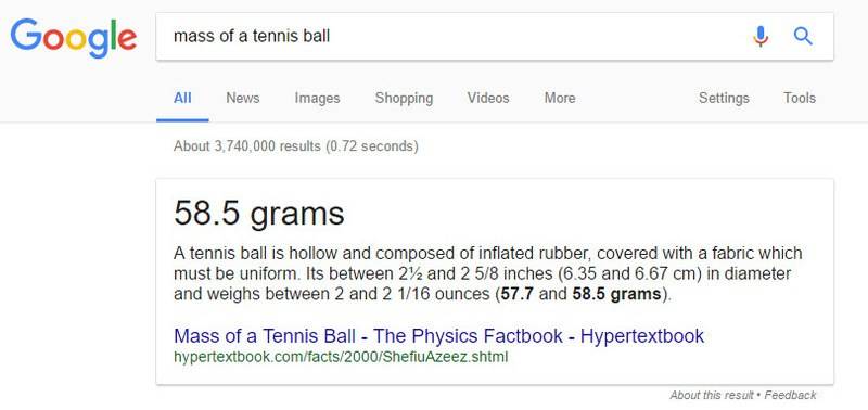

Regarding the tennis ball mass and diameter, I was just going by:

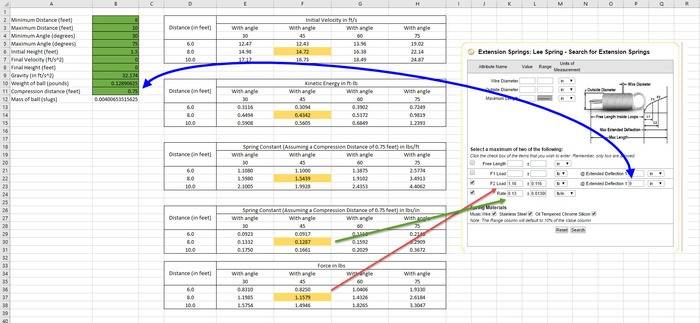

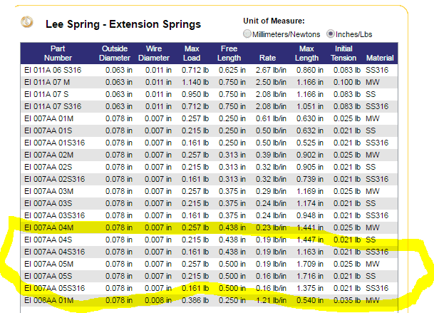

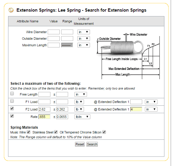

Apparently now US spring manufacturers now allow both US and SI units to be used, below is an online catalog for Lee Springs, who I have used for years for off-the-shelf spring purchases. Just click on the style of spring you want and you will see how to do a selection using either US or SI units.
http://www.leespring.com/
As a retired american engineer who is required to use SI for many problems on this forum, SI is just as frustrating for me as US is for you.
To maintain units consistency with the in/sec for the ball velocity and in. for the spring displacement and so I could get the spring constant value in standard US lb/in rather than a nonstandard lb/ft.

At 45 degrees, I seem to be getting a different velocity than you. I'm not sure why that is, but assuming the calculations are correct otherwise, this image is where I'm at now on the process. Though I am definitely losing track of units at this point.
  • Initial Velocity is in ft/s.
  • Then Kinetic Energy is ... ft-lb (I think), or am I now in slugs, or ft-in, or ...?
  • And the Spring Constant is now lbs/in I believe.
  • And finally the Force is just pounds?

I used 4.5 m/s * 39.37 in/m = 177.165 in/sec
  • #34
Our velocity values don't differ by much, my 177.165 in/sec converts to 14.76 ft/sec as opposed to your 14.72 ft/sec.

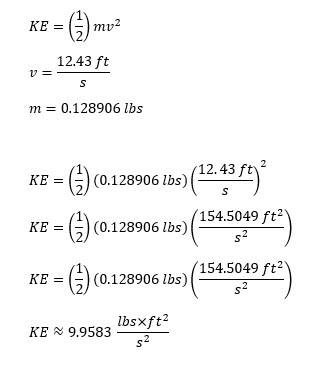

I see that in your spread sheet, you show the mass in pounds. This simply will not work right.
g is the acceleration of gravity (this is almost universal usage).
If you use feet for length,
then
velocity is in ft/s
acceleration is in ft/s^2
weight is in lb
energy/work is in ft-lb
g=32.174 ft/s^2
If you use inches for length,
then
velocity is in inches/s
acceleration is in in/s^2
weight is in lb
mass is in lb-s^2/in
energy/work is in inch-lb
g = 386.088 in/s^2
The key is be consistent.
