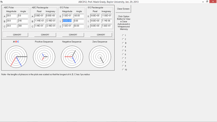

Sorry I made a mistake in the inputting to calculate the symmetrical values.
Start again: the resultant phasor values are (using Badabung's convention):
Ia = 28.75 arg(0)
Ib = 28.75 arg(240)
Ic from Badabung =-14.38+24.9j = 28.75 arg(-60) = 28.75 arg(300) = this is the resultant neutral phasorThe calculator for Symmetric components gave me
I0 = 19.2 arg(-60)
I1 = 9.60 arg(0)
I2 =19.2 arg(60)
Ia = 28.75 arg(0)
Ib = 28.75 arg(240)
Oh dear, Ic = 0. Phase C is dead broken (remember?) and no current can be flowing through it. You should really learn basics of this stuff...
Likes CasterSkux
Sorry I've attached Ic as the resultant vector of A + B, it's a terminology error. I'd like to learn more but we don't get enough practice excersizes unfortunately:(
I really do appreciate your help though Zoki!
