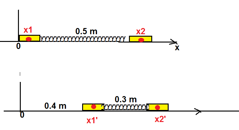

Two identical 0.50-kg carts, each 0.10 m long, are at rest on a low-friction track and are connected by a spring that is initially at its relaxed length of 0.50 m and is of negligible inertia. You give the cart on the left a push to the right (that is, toward the other cart), exerting a constant 5.0-N force. You stop pushing at the instant when the cart has moved 0.40 m. At this instant, the relative velocity of the two carts is zero and the spring is compressed to a length of 0.30 m. A locking mechanism keeps the spring compressed, and the two carts continue moving to the right.
(a) What is the work done by you on the two-cart system?
(b) How far does the system’s center of mass move while you are pushing the left cart?
(c) By what amount do you change the system’s kinetic energy?
w=f*d
<work done a system>
a) w=5N*(0.4m)=2J
I think this is right, but
b) center of mass initial = ((0.5kg)(0.05m)+0.5kg(0.65m))/1kg = 0.35m
center of mass final = ((0.5kg)(0.45m)+0.5kg(0.4+0.1+0.3+0.25))/1kg = 0.75m
I'm not sure for this one... How can I calculate the displacement of the center of mass??

For part (b), I don't understand the 0.25 term in the calculation of the final position of the center of mass.

What I thought was since the left-most cart moves 0.4m and the spring compressed 0.2m from the original, then the displacement of the right-most cart would be 0.2m, so my final position of the center of mass would be ((0.5kg)(0.45m)+(0.5kg)(0.4+0.25)m)/1kg= 0.55m.
So the displacement of the center of mass would be (0.55-0.35)m=0.20m?

Yes, I overlooked that you are given the compressed length.
How do you get the 0.35?
A figure may help :smile: The length of both carts is 0.1 m. Supposing that their CM is in the middle, the initial position of the CM of the first cart is
x1=0.05 m, the spring is 0.5 m long, so x2= 0.65 m.
I got this one with ((0.5kg)(0.05m)+(0.5kg)(0.65m))/1kg = 0.35m!
x1=0.05 m, the spring is 0.5 m long, so x2= 0.65 m. View attachment 259642
Then the final position of the second cart would be (0.4+0.1+0.3+0.05)m ?
Looks good.
