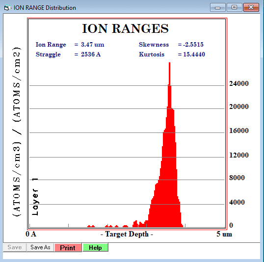

In your OP you indicated a hydrogen ion but you meant He? How thick is your tungsten target? For a 2.5 Mev
He++ ion mean depth of penetration in tungsten, is estimated to be about 3 x 10 -4 cm.
2.5 MeV He ions have only a 1.3 cm range in air.
Your irradiation time depends on how much He you want to implant.
Also, I do not expect the energy deposition or the He concentration to be uniform vs depth.

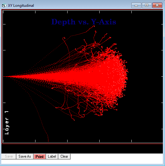

About first questions: all information you can get from SRIM code.
Simulation was done according to task (He ions in W target). First pic destributions of ions in target, second pic ions pass(red) stopped ions(white).
