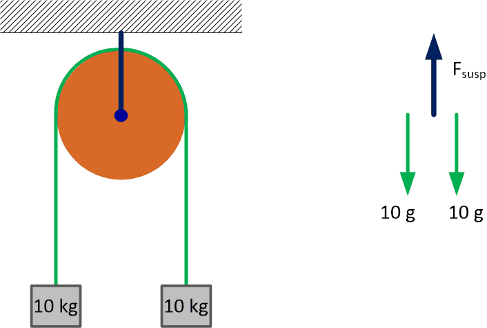

By now your helpers think it necessary you learn how to draw a free body diagram :rolleyes: for an object (e.g. a pulley):
Simply draw all the forces that act on one object
Example: massless pulley with massless rope, from each end of which hangs a mass of 10 kg :
Situation sketch on the left, FBD on the right. Only way the pulley can stay in equilibrium (i.e. not accelerate in any direction) is if Fsusp = 20 g Newton. That is the upwards force the pulley exerts on the suspension.
Likewise you can draw FBDs for the left mass, right mass, blue suspension bar, ceiling, rope, etc.
For your spider the situation is different, but not too much. Can you draw a free body diagram and post it ?

I'm pretty confident with drawing free-body diagrams. I just posted one from the Internet because it would have been more hassle to draw my own, take a picture, upload it, and post it.
OK, good. Carry on !
