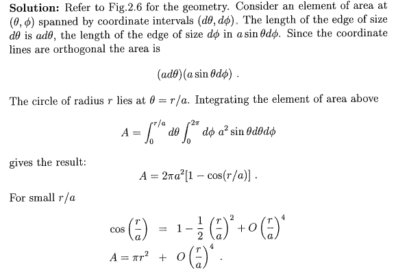

Hi all, I am working through Gravity by James Hartle and have become stuck on a question asking me to calculate the area of a circle of radius r in the 2D geometry that is the surface of a sphere of radius a.
A surface element on this sphere can be found to be (adΘ)(asinΘdΦ) (see attached image).
Integrating the above surface element over Θ=0 to Θ=r/a, and Φ=0 to Φ=2π, I obtain A=-2πa2cos(r/a). The answer given in the solutions manual is this, plus 2πa2. I don't understand how the additional 2πa2 comes about.

Here I have attached also the solution. I have no idea how he goes from the surface area element (adΘ)(asinΘdΦ) to the integral shown for the area A. (There is an extra dΦ and dΘ?)

The answer of course makes sense, it is the procedure that is confusing me. Specifically, the step where he goes from deriving the infinitesimal area element (adΘ)(asinΘdΦ) to the part where he says, "Integrating the element of area above...". It is the integrands that make no sense to me. Why are there two dΦ and dΘ terms? Isn't (adΘ)(asinΘdΦ)=a2sinΘdΘdΦ, then this is integrated?

I'm sorry, I'm still not understanding. Here is my issue (maybe in tex it will be clearer, I was learning to use it and this will be my first time):
Differential rectangle from diagram:
[tex]1. (ad \theta )(a \sin \theta d \phi )[/tex]
Then he says, "The circle of radius r lies at [itex] \theta = r/a[/itex]." This part I understand.
Next, "Integrating the element of area above,"
[tex]2. A=\int_0^{r/a} d\theta \int_0^{2\pi} d\phi a^2 \sin \theta d\theta d\phi [/tex]
In going from step one to step two, where does the extra [itex]d\theta[/itex] and [itex]d\phi[/itex] come from? Once this is explained, how am I to integrate a [itex](d\phi)^2[/itex] term?
Furthermore, isn't the result of [itex]\int_0^{r/a} d\theta[/itex] simply [itex]r/a[/itex]? How does r/a end up inside the cosine term?
I'm sorry if I'm missing something very obvious, and I appreciate the help I've received so far. This problem has been bothering me for the past week, math tutors at my college haven't been able to explain this to me.
Ah. Now I see what you're saying. You're right, of course. There are some typos in that equation.
Chet

Good, now I know I am not going crazy looking at this solution haha. Unfortunately there still remains the question of how to obtain the answer he gets.
My method was to integrate the differential rectangle:
[tex]\int_0^{r/a}\int_0^{2\pi} (ad \theta )(a \sin \theta d \phi ) [/tex]
to obtain: [tex] -2\pi a^2 \cos (r/a)[/tex].
As you can see, the book's answer is [tex] 2 \pi a^2 - 2 \pi a^2 \cos (r/a) [/tex]. So where does that extra [itex] 2 \pi a^2 [/itex] come from?
And NascentOxygen, I believe the O() represents the rest of the cosine power series from the third term on.
The problem is with how you applied the limits of integration. I get:
##2\pi a^2[-cos \theta]_0^{r/a}##
What does this give you?
Chet
Chet
Of course. I knew it would be a obvious bonehead mistake of mine. Thank you! so much for this and all your help sir.
