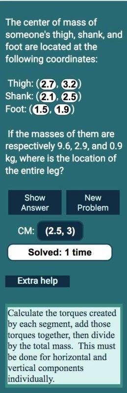

The center of mass of someone's thigh, shank, and foot are located at the following coordinates:
Thigh: (2.7, 3.2)
Shank: (2.1, 2.5)
Foot: (1.5, 1.9)
If the masses of them are respectively 9.6, 2.9, and 0.9 kg, where is the location of the entire leg?
ANSWER:
CM = (2.5, 3)

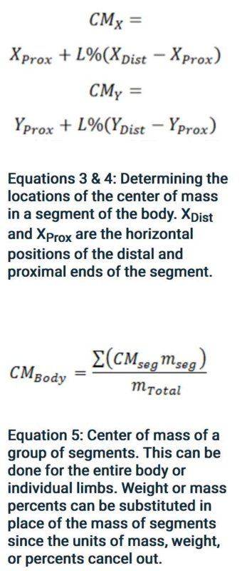

CMx = Xprox + L%*(Xdist - Xprox)
CMy = Yprox + L%*(Ydist - Yprox)
CMbody = E*(CMseg*Mseg)/Mtotal
Thigh: (2.7, 3.2)
Shank: (2.1, 2.5)
Foot: (1.5, 1.9)
ANSWER:
CM = (2.5, 3)I'm having trouble figuring out the steps for this. I feel like I need to know the Length % in order to complete the formula but am lost as to how to get this. Thank you for any help you may be.
-E
Please define the parameters in your equations.
I was having a hard time uploading screenshots of the equations/problem. I think I got it to work now.
So in the bottom of the screenshot, it talks about calculating the torques for each segment. Do you know how to do that?
Think about a simpler problem, like a 1 dimensional bar with weights attached at different points. How would you find the center of mass? Now how would this be expanded to 2 dimensions?
So I know T (Torque) = F (Force) * ⊥d (Perpendicular Distance).
Would it be: 2.7 * 9.6? Am I even close?
Yes, you're on the right track.
Oh my gosh, thank you so much guys!
X
2.7 * 9.6 = 25.92
2.1 * 2.9 = 6.09
1.5 * 0.9 = 1.35
SUM OF TORQUES = 33.39
DIVIDED BY SUM OF MASS = 13.4
33.39 / 13.4 = 2.5
Y
3.2 * 9.6 = 30.72
2.5 * 2.9 = 7.25
1.9 * 0.9 = 1.71
SUM OF TORQUES = 39.68
39.68 / 13.4 = 3
