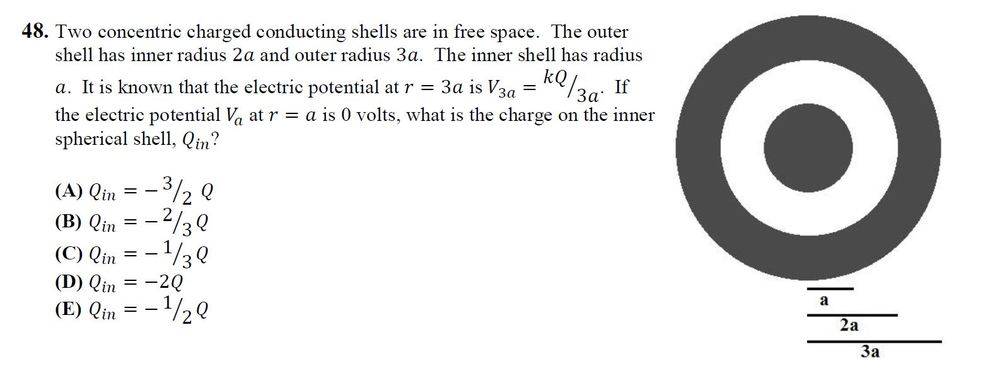

In summary, the homework statement is trying to solve for the potential of an electrostatic conductor, but is not able to do it directly due to the charge on the inner surface of the outer shell.
Miles123K
57
The solution to this problem is B, and I was able to get the answer by calculating the total potential at ##r = 2a##, however, what I don't seem to understand is why must the voltage be calculated at ##r=2a## but not ##r=3a##.
##V(r) = - \int_a^b E(r) dr##
##V(r) = \frac 1 {4 \pi \epsilon_0 } \frac Q r##
For solving the problem at ##r=2a##, I used the voltages at ##r=a## and ##r=b##
##V(a) = \frac 1 {4 \pi \epsilon_0 } (\frac {Q_1} {a} + \frac {Q_2} {3a}) = 0## where ##Q_1## is the inner charge and ##Q_2## is the outer charge.
##V(2a) = \frac 1 {4 \pi \epsilon_0 } (\frac {Q_1} {2a} + \frac {Q_2} {3a}) = \frac 1 {4 \pi \epsilon_0 } \frac Q {3a} ##
By simple algebra I was able to solve for ##Q_1## and it was B, however, the condition given was ##V(3a) = \frac 1 {4 \pi \epsilon_0 } \frac Q {3a} ##. why do I have to use the argument that an electrostatic conductor have the same potential throughout to work out the potential ##V(2a)## but not directly solve for ##Q_1## at ##r=3a##?

You seem to be ignoring any charge on the inner surface of the outer shell.
Oh right yes. Thanks for the tip. Now I get it. It's actually three equations instead of two.
Here's my solution:
By writing out the potentials and cancelling out the constants, I got the following three equations:
##q_1 + \frac 1 2 q_2 + \frac 1 3 q_3 = 0##
##\frac 1 2 q_1 + \frac 1 2 q_2 + \frac 1 3 q_3 = \frac 1 3 Q##
##\frac 1 3 q_1 + \frac 1 3 q_2 + \frac 1 3 q_3 = \frac 1 3 Q##
By solving this simultaneous equation I got
##q_1 = - \frac 2 3 Q, q_2 = \frac 2 3 Q, q_3 = Q##
##q_1## is the inner most shell, ##q_2## is the inner surface of the outer shell, ##q_3## is the outer surface of the outer shell.

Looks right.
