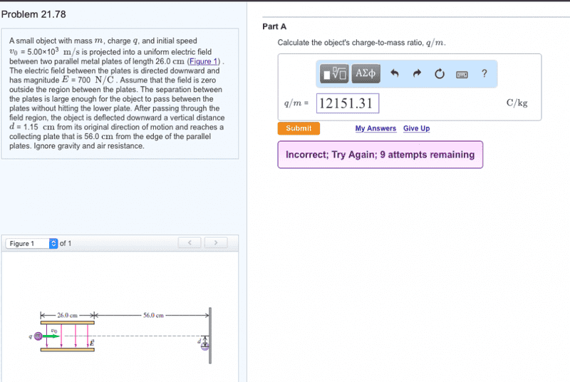

A small object with mass m, charge q, and initial speedv0 = 5.00×10^3 m/s is projected into a uniform electric field between two parallel metal plates of length 26.0 cm (Figure 1) .The electric field between the plates is directed downward and has magnitude E = 700 N/C . Assume that the field is zero outside the region between the plates. The separation between the plates is large enough for the object to pass between the plates without hitting the lower plate. After passing through the field region, the object is deflected downward a vertical distance d = 1.15 cm from its original direction of motion and reaches a collecting plate that is 56.0 cm from the edge of the parallel plates. Ignore gravity and air resistance.
E=F/q
xf=xi+vi*t+(1/2)at^2
Since gravity and air resistance air are not factors, I thought the only thing affecting the motion of the object is the electric field. Using the horizontal velocity, I calculated the time that the object was between the plates. Then, using that and the second equation I calculated the vertical acceleration of the object. From there, I expanded the first equation into E=(m*a)/q and plugged in the acceleration and given electric field and solved for q/m

Your method, as far as you describe it, sounds right. Not clear what you did in regard to the travel after the plates. Please post your working. Please keep it symbolic (no plugging in numbers) until the final step.
The objective is to find the charge to mass ratio, I have attached a screenshot of the problem.
The issue I'm having is, how do i go about finding the y velocity after it exits the E field. and how do I find the acceleration on the object by the E field if i don't know the displacement during its time in the E field.
Let the acceleration in the field be a. Calculate where it should end up on the screen in terms of a.
Since these things depend upon quantities you don't know (the mass and charge), you should leave them as variables.
Edit: Note that the problem wants you to find the ratio q/M. Figure that at some point you'll be able to insert some variable (maybe call it "r") to represent q/M. I'd take a look at your acceleration and see what it depends on.
