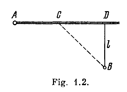

Speed on a highway = v
Speed in the field = η v, is this what is meant by η times smaller?
Let's denote CD by x.
Now, time taken is
t = (AD - x )/v + {√(x2 + l2)}/ ηv
Now, time taken is
