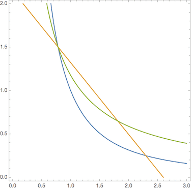

Here's a pV diagram that might help. The blue curve is an adiabat, and the green one is an isotherm. I believe Andrew is saying the isotherm divides the orange line between the two endpoints into two segments, and on the top segment, the engine absorbs heat while on the bottom segment, it rejects heat.
You want to find the point where 0 = dQ/dV = dU/dV ± dW/dV (not sure what sign convention you're using). I'm not convinced that occurs where the isotherm crosses the line, though.
Note: The units on the axes of the diagram aren't relevant to this problem. I just made up numbers to get a reasonable looking diagram. Also, my calculations show that the crossover between heat absorption and heat rejection wasn't where the isotherm intersected the line.
I was not saying necessarily that the point where dQ/dV = 0 is the intersection with the isotherm. I was just saying that up to that point there has been net heat flow into the system and after that point net heat flow is negative (out of the system).
I am not sure where dQ/dV = 0 but I agree that this is what you want to find. Up to that point, dQ/dV>0 (heat flow is in) and after, dQ/dV<0 (heat flow is out). From the first law, dQ/dV = dU/dV + dW/dV = dU/dV + P (W is the work done by the gas). So you want to find the point on the line where dQ/dV = 0 i.e. where: dU/dV = -P.

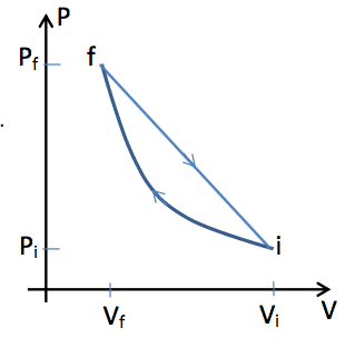

A thermodynamic cycle consists of only 2 processes and uses a monatomic ambient gas, First, the monatominc gas is compressed adiabatically from the initial pressure Pi=1 bar to Pf=5 bar starting at temperature Ti=300 K The initial volume of the gas before the compression is Vi=10 liters. In the second process gas expands along straight line on the PV diagram. Find the Efficiency.
Here's what I have got so far:
Pi=10^5 Pa
Vi = .01 m^3
ni = .4 mol
Ti = 300 K
Pf = 5*10^5
Vf = .0038 m^3
nf = .4 mol
Tf = 571.6 K
Wtotal = 1354.2 J (adiabat) + -1860J (linear) = -505.8 J
Qi->f = 0
Qf->i = 505.8 J = Qh + Qc
Part of this is the sum of heat absorbed and heat given off. this doesn't make a whole lot of sense to me because the process absorbs more heat than it exhausts, but the temperature drops...
I found the eq for the linear expansion to be ##-6.45*10^7V + 745161##
knowing this and I found the temperature during expansion to be ##T = \frac{-6.45*10^7V^2 + 745161V}{.4*8.31}##
and the max temperature would be 647.308 K at V = .00577644 m^3
Seems strange that the temperature would rise during expansion first... but it isn't for long. .0038 -> .0058 is pretty short between .0038 and .01
What do I do. I know this is a lot to ask. I don't think I learned what you are talking about.
I can scan my work and upload it if necessary?

edit: I keep looking at your hint, and I'm not getting what I am supposed to do.
what does
solve dU/dV = -P mean?
i am thinking that U = nCvdT . and U = W + Q . So I can find the U and W during the temperature rise, subtract, and I will be left with Qh.
but v isn't constant. so I take the integrate with respect to V...
grandpa2390 said:
Someone else told me that I have to draw a t-s diagram? is that what we are doing?
Essentially, yes. We are trying to determine the relationship between P, V (or T) and heat flow (Q). A T-S diagram will show the relationship between temperature and heat flow. A T-S diagram will be a vertical line for the adiabatic portion and a curve on the right side (looking like a D shape overall) for the expansion portion. So if you can draw a T-S diagram for the expansion, you look for the point where S is maximum (i.e. the point farthest to the right). The area below the lower part of the curve from at that point is Qc and the area below the upper part of the curve is Qh. The area inside the curve is Qh-Qc. We are trying to find the point at which S is maximum, ie. where dS/dT = 0. This should also be where dQ/dV = 0 (in which case dU/dV = -P).
what does
U = Cv(PV/R)
Work out dU/dV and set it equal to -P. The solution will give you the point on the line where dQ/dV is zero. Before that point, heat flow is in. After, heat flow is out.
By the product rule:
dU/dV = (Cv/R)(P + VdP/dV)
Work out dP/dV from the relationship between P and V that you derived.
AM
  • #31
U = Cv(PV/R)
AM
##\frac{dU/dV}{C_V/R} - VdP/dV = P##
I don't know what to do with this. thanks for trying, but my assignment is due. Time to embrace my F. I wasted an entire week trying to figure out this one problem, my time would have been better spent studying for other classes :(
it's why i pleaded to be directed towards a video lecture or something that could walk me through to understand the concepts I need to solve this problem.
I do not have the knowledge I need to follow hints. I need instruction.
  • #32
Set dU/dV = -P to determine where heat flow direction changes (dQ/dV = 0 or dS/dT = 0)
ie. ##dU/dV = \frac{Cv}{R}(P + V\frac{dP}{dV}) = -P##. Substitute dP/dV from the equation for your expansion line (hint: it is a line of constant, negative slope and dP/dV is the slope).
##\frac{Cv}{R}(P + mV) = -P##
3) ##V = \frac{P}{m}\left(\frac{Cv}{R} + 1\right)##
Since the expansion line is of the form: P = mV + b substitute mV + b for P in 3). That will give you the value of V where dQ/dV = 0. I didn't say it was easy.
This is a very difficult problem. I doubt that you were expected to solve it. Give it your best shot. Look at it as a good learning experience.
AM
  • #33
AM
I don't know. We took a test and I didn't do so well. Apparently nobody else must have either because he sent this problem out for us to do for an extra three points if correctly done.
And he said it was OK to ask for help from people and so forth otherwise I wouldn't of asked. But it was due today but now it's too late. I wrote down all the information I found it figured out. And explained the problem I ran into. I probably failed. But maybe I'll get enough partial credit to pass
I'm already having to do my best to teach myself on the book and these problems are not like anything in the homework or otherwise
Take home questions ought to be difficult. But to ask questions that require concepts not taught... :(
