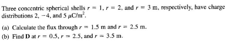

Question

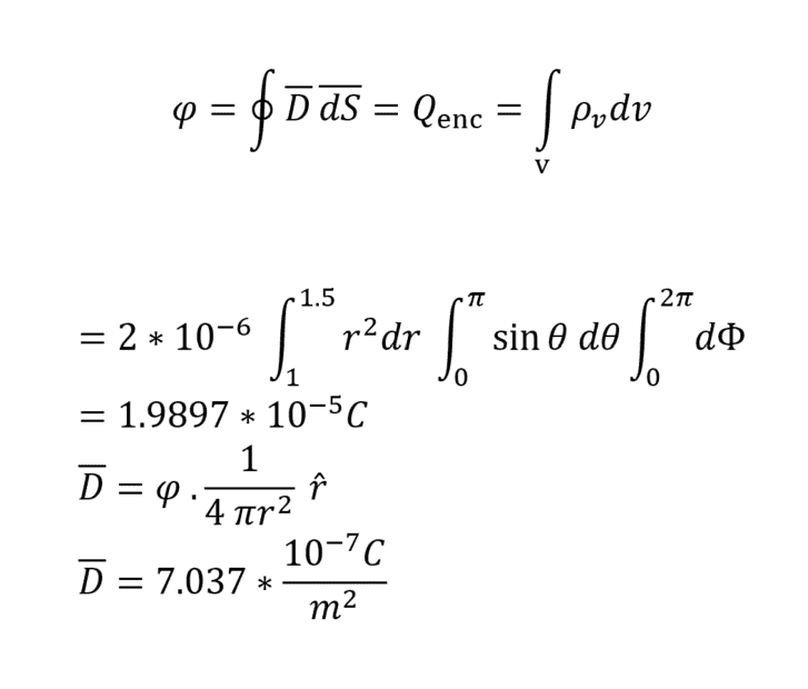

My attempt for the 1st part, when r = 1.5 m
Could someone confirm my answer?
Hi,
Do you know what a shell is ?
You seem to integrate something from 1 to 1.5 m. What is that ?
Did you notice the dimension of the given charge distributions ? Does that match your ##\rho_v## ?
I also have trouble understanding what your symbols mean. ##\phi = Q## ?

You are asked to calculate the flux through ##r = 1.5## m as a starter in part (a).

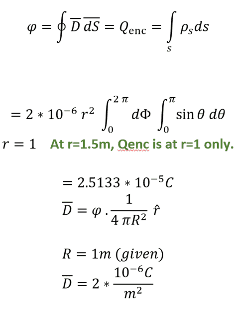

In post #3 the volume integral you wrote in post #1 is replaced by a surface integral. Good ! And you write $$\phi = \oint \overline D\, \overline{dS} = Q_{enc} =\int \rho_s ds$$ where I must suppose ##D = \varepsilon_0 E## ?
In my book the electric flux in such a nice spherically symmetric case is ##\Phi = EA## with E the electric field strength in Newton/Coulomb and A the area in m2 . In other words, I get $$\Phi = \oint {\overline {D}\over \varepsilon_0}\; \overline{dS} = {Q_{enc}\over \varepsilon_0}$$ and the units are Nm2/C.
We are still in part (a) first question. I agree that ##Q_{enc} = \rho_s \, 4\pi \,r^2## with ##r = 1 m##.

Your exercise composer makes life difficult by re-using symbol ##r## in r = 1.5 m where ##D## is asked for. We no longer need the ##\varepsilon_0##.
You are smart enough to replace ##r## by ##R## (without explaining:mad:) but then you take ##R= 1 ## m (given) ?

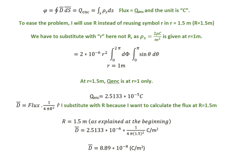

I was so confused in using many r's, so I use different symbols, and tried to solve it again. Here's my attempt with my explanation:

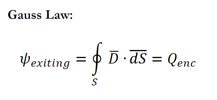

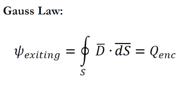

And regarding the following formula:
This is given in the textbook.
If the flux it is the total inside charge you have to calculate D at r=2.5 [or r=0.5] and not at r=1.5
