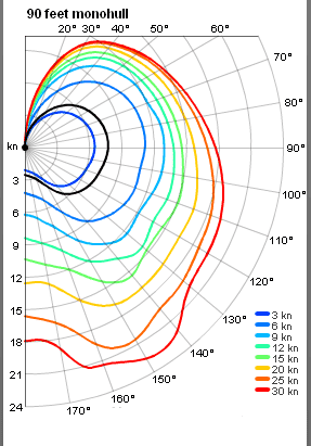

But what I really had in mind were curves such as the one below that are hull specific. It looks like what rcgldr said was correct for most hulls and weather.
But I stand by what I first said. There is no defined speed limit sailing upwind.. Only drag limits.
