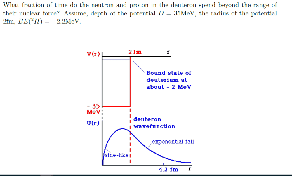

Please see image
Please see image
I want to compute the fraction of time both particles spend outside the finite potential well. All I can get is the probability to find them outside. The wavefunction outside the potential is:

Suppose you had a way to measure whether the particles are outside the potential well. You repeat the measurement ##N## times and you find that ##m## times the particles were outside well and ##N-m## times they were inside the well. The ratio of the times the particles were outside the range to the total time is ##m/N##. That's the fraction you are seeking. What does the area under the "exponential fall" in the figure represent?
Likes JD_PM
I agree. But how can I get a quantitative result? Should I go for calculating the transmission coefficient?

The area under the "exponential fall" is just the probability of finding both particles outside the potential well: ##\int |\psi_{II}(r)^2|dr##
JD_PM said:
The area under the "exponential fall" is just the probability of finding both particles outside the potential well ...
How is this different from "the fraction of time (that) the neutron and proton spend beyond the range of their nuclear force"? My thinking is this: Suppose you measure the position of the particles at the rate of one measurement per minute and you do this for an hour (60 measurements total). Also suppose that you found the particles beyond the range in 15 of the measurements, randomly distributed in the 60 minute interval.
What is the probability that the particles will be found outside the range? Answer: 15 out of 60 measurements = 1/4.
What is fraction of time that the particles spend beyond the range? Answer: 15 minutes out of 60 minutes = 1/4.
