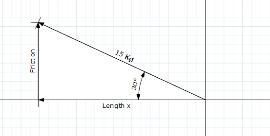

Given an object of mass 15kg sits on a slide, at an angle of 30 degrees to the horizontal, what is the magnitude of the frictional force acting on the box if the box does not slide down?
So, I know this is a scalar vector; so I'll be using the Dot Product.
I've plotted it as a vector (attached below)
I've solved for 'Length x' using [tex]Sin 30=x/15[/tex] which turns out to be 7.5
From this, I used the dot product where ||a|| * ||b||*Cos[tex]\theta[/tex] = Friction
Let:
||a|| = 15
||b|| = 7.5
[tex]\theta[/tex] = 30
Giving the friction as approx. 97.42...not sure if this is the right process though.
It would be easier to think of this in forces. The frictional force would be equivalent to the component of the force due to gravity that would point down the ramp, since they must cancel. Break gravity down to find that. Are you required to use a dot product here?
The question is off a worksheet which had required me to use Dot/Cross Product all the way through it, so I've kind of assumed that I'd have to use it for this question.
Hmm, weird. OK. Then you will want to find the projection of the force due to gravity on a vector that points down the ramp. That will require a dot product. Recall projections?
Your friction vector should be (using your diagram's orientation) at 150 degrees.

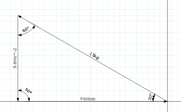

Righto, here's my new attempt:
We know:
Weight of Box (Magnitude a) of 15kg
Gravity's Force (Magnitude b) which acts down on the box 9.8ms-2
Friction is unknown
Angle between is 30
Friction is a vector quantity, so we use cross product ||a||*||b||*Sin Theta
So:
[tex]||a||\times||b||\times Sin\Theta[/tex]
[tex]15kg\times9.8ms^{-2}\times Sin30[/tex]
[tex]=73.5kgms^{-2} = 73.5N[/tex]
Is that right?
Umm, that is the correct answer, but not the correct method. You shouldn't need the cross product. You defined mass as a vector, and then gravity as a vector, and then said they point in different directions. That is incorrect. Mass is a scalar, force from gravity is a vector. You want to find the projection of the force vector due to gravity on the ramp. (The reason for this is that you are assuming that friction is cancelling out the force that gravity "projects" down the ramp.) So just dot a unit vector in the direction of the ramp with the weight vector. You will end up with the exact same terms, except the 15*9.8 will be wrapped up in the magnitude of just one of the vectors.

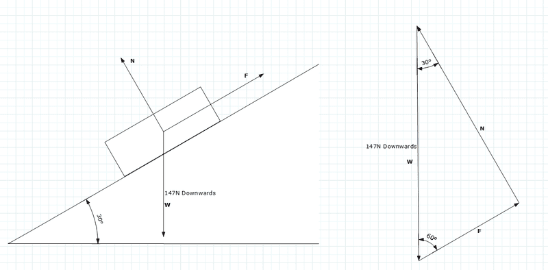

No, mass is not a vector. Your two vectors will be a unit vector pointing in the direction of the ramp and a weight vector pointing down. The weight vector will have a magnitude of (9.8)(15) = 147 (Newtons, if it matters).
Uhm...what about now?
Correct.
