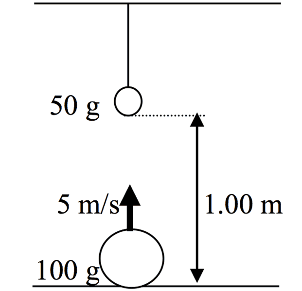

A ball of mass 100 g is projected straight up with a speed of 5 m/s from the floor. Another ball of mass 50 g is hung from the ceiling by a light string at a height of 1.00 m directly above the first ball, so that the projected ball collides elastically with it. Calculate the height above the floor to which the smaller ball will rise.
1/2 M1V1i^2 = 1/2 M1V1f^2 + 1/2 M2V2f^2
When I use the equation above it gives me two unknown variables V1f and V2f (after the collision). but I don't know what equation to use to figure out Δy.

You're using conservation of energy. Energy is not the only thing conserved in elastic collisions. In fact, the thing I'm thinking of is conserved even in inelastic collisions.
