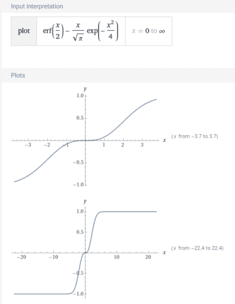

For a=1 the plot is

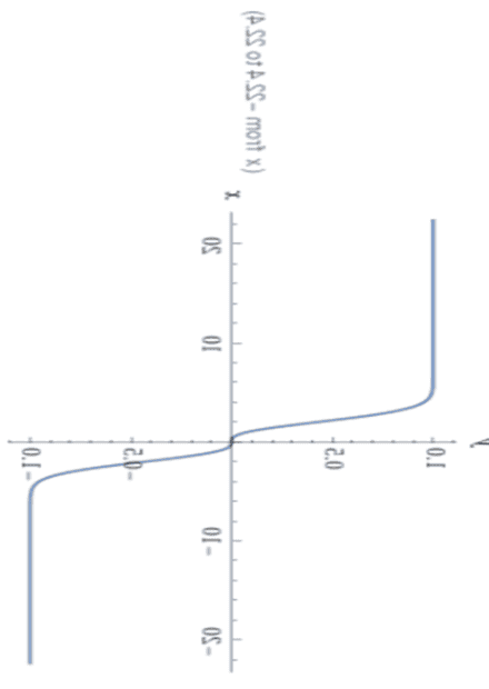

So the expected plot of the inverse function is
It seems difficult to get the anaytical form if not impossible.
