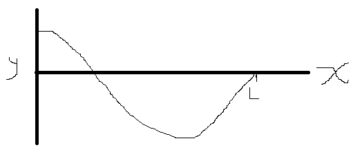

I think I've done parts (i) to (iii) but I'm struggling with part iv. We have what the wave equation for the standing wave is so I think this should just be a case of using a boundary condition for the ends of the string. The one I've been using is that ##y_s(x,t)=0## when ##x=L \forall t## where L is the length of the string. This boundary condition being taken from the wave equation of the reflected wave being inverted and traveling in the opposite direction to the incident wave so it has a fixed end.However, this gives me that $$sin(kL+\phi)=0 \implies L=\frac{n\pi-\phi}{k}$$ where n is a positive integer.
Firstly, is this correct? And secondly is there a way for me to figure out which value of n to use? I recall that for a string with one free end and a fixed end we should only have odd numbered harmonics but i see nothing here excluding the even values of n. I did consider using a second boundary condition for x=0 but it seems like as we have fixed values of A,##\phi## and k we already know what the amplitude at x=0 has to be.

Thanks for responding but won't this method give a time varying answer since when the wave is at its full amplitude the integral here will be larger than when the string is completely at equilibrium position? I think the L I'm looking to find is the x coordinate of the end of the string as shown in the picture I've attached (Apologies for the awful picture). Could you elaborate as to why the method I've tried to use is wrong?
Well, L isn't the length of the string, it's the strings projection onto the x axis. The answer won't be time varying, as it's the same length at every point. So just pick some time, t , such that sin(wt) = 1 to make it easy. Then solve the integral. It's sinusoidal in t, but for any t, the integral should be the same.

I suppose there are two approaches to this. Assume A is very small, and solve for L (and essentially that the string is elastic). By solving for L, you're solving for the minimum length of the string.
The other approach, which would be solving the max length, is to do what I outlined above, and set sin(wt) = 1, and then use arc length of f(x).
The more I think about it, with the given information, I think you are supposed to assume that the length is the same at max as it is at min. So then yes, L would be the length, which would be some integer multiple of the wavelength.
