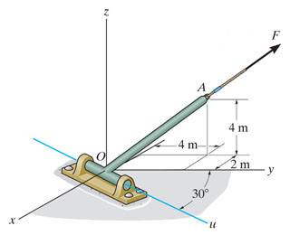

Determine the magnitude of the projection of force F = 700 N along the u axis
A(-2, 4, 4)
r(AO) = 2i -4j - 4k
r(AO mag)= 6
u(AO) = 1/3i - 2/3j - 2/3k
F(AO) = 233.3333i - 466.6667j - 466.6667k
I'm not sure where to go from here. The only info I can figure about u is the 30 degree angle between it and the y axis.

Hmm. Don't you mean F dotted with u? Note that F lies along the direction OA. So you'll need to construct a vector for F and another for the u unit vector. That 30° angle should come in handy for the latter.
F = 233.3333i - 466.6667j - 466.6667k
I guess I'm just not seeing the u unit vector. And, yes, that is what i meant.
I think you need to check the signs of your F components. It looks to me from the diagram that F is pointing towards the negative x-axis, positive y-axis, and positive z-axis.
The u unit vector should lie along the u-axis. Use a bit of trig to find the x and y components. It appears to lie in the x-y plane...

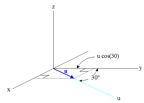

The simplest approach to finding a unit vector is to imagine that it sits within a unit circle, and then the sine and cosine of a suitable angle will give your the components directly. The magnitude of any vector with unit length is always unity, just like the radius of the unit circle.
The axis u is indicated as having an angle of 30° with respect to the y-axis. So you should expect the y-component to be the cosine of the angle and the x-component to be the sine of the angle. You seem to have found the opposite (and I don't really understand where your value of 4 came from... there's nothing indicated in the figure that ascribes a dimension of 4 in relation to the u-axis).
This is what you have to work with:

u is a unit vector along the positive u-axis. Refer to the diagram that I posted.
All you need in order to find a projection along a given direction is to dot a given vector with a unit vector in the desired direction. Works with any unit vector; You can try it with your F vector and the unit vectors for the x,y, and z axis if you like. Take the dot product of F with any of the axes unit vectors and you should "extract" that component from the F vector.

You've mixed up the components of u again. Look at the diagram in post #8. Is the sine of the angle along the y-axis or the x-axis?
sin=x
cos=y
Robb said:
sin=x
cos=y
Right. And sin(30°) = 1/2, while cos(30°) = √3 / 2.
