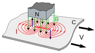

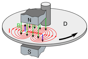

Eddy currents want to flow in circles -
A conductive surface moving past a stationary magnet will have circular electric currents called eddy currents induced in it by the magnetic field, due to Faraday's law of induction. By Lenz's law, the circulating currents will create their own magnetic field which opposes the field of the magnet. Thus the moving conductor will experience a drag force from the magnet that opposes its motion, proportional to its velocity. The electrical energy of the eddy currents is dissipated as heat due to the electrical resistance of the conductor.

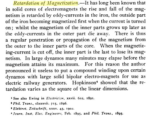

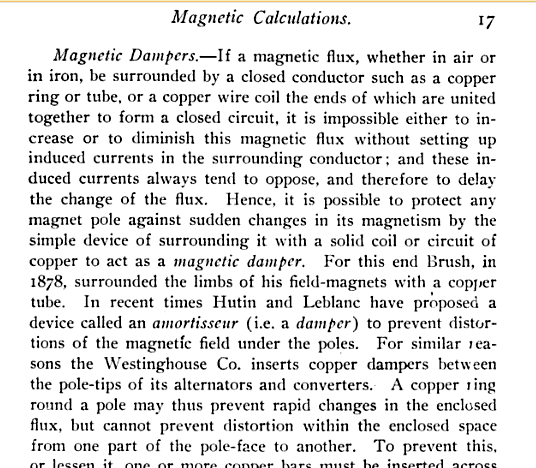

from my old 1901 electric machinery book
https://books.google.com/books?id=9...ompson "retardation of magnetization"&f=false
