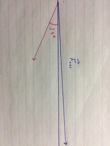

Calculate the net force acting on the object in the following diagram:
cosine law / sine law
ONLY solving using cosine/sine laws.
First using the cosine law to find the magnitude of the net force:
c2=a2+b2-2abcosC
c2=122+152-2 x 12 x 15 (cos124)
c2=369-(-201)
c2=570
c=23.9N
Now using sine law to find the angle:
sina/12=sinb/15=sin124/23.9
b=sin-1 (sin124/23.9 x 15)
b=31 degrees
Now I just don't know in which direction am I supposed to say it is pointing towards? Because if you look at the diagram and my work, it looks as if it is almost straight East. What should I do?

Are you saying that you are asked to find the direction of the resultant using the laws of sines and cosines only? If so, it looks like the resultant is pointing a certain number of degrees "North of East". What is that number? Hint: First find how big angle a is in your drawing.

So I found for angle a using sine law:
sina/12N = sin31/15N
a = sin-1(sin31/15 x 12)
a = 24.3 degrees
I'm not sure what to do after this step, and honestly I don't believe I "have to" use only cosine, sine laws, however that is what I've been taught in the lesson. I got the exact same answer (23.9N) for the magnitude of the net force by solving the exact same way as in this video:
https://www.khanacademy.org/math/pr...ns-of-vectors/v/vector-component-in-direction
Which is basically just adding the vectors to get the sum, which is the net force.
But I'm pretty sure the answer would require a direction as well, no?
Maybe it isn't asking me of direction too; if I were to perfectly re-draw the diagram, wouldn't the net force be facing directly towards East, just like that middle dotted line in the original diagram?

Humbleness said:
a = 24.3 degrees
OK, and what is the angle that C makes above the horizontal (East) direction? That's the angle "North of East".
Yes. Force is a vector and when you are asked to find a vector, you must supply magnitude and direction. If you were meant to supply the magnitude only, then there should be language in the problem to that effect.
Humbleness said:
... if I were to perfectly re-draw the diagram, wouldn't the net force be facing directly towards East, just like that middle dotted line in the original diagram?
No. I did the problem and the angle above the horizontal is small but not zero. I suggest that you redo the calculations to five decimals. You can always drop some in the end.
Likes Humbleness
Clever...
(Showing in the attachment that it's true, it isn't exactly going east.
I re-did the calculations with 5 decimals, as you suggested, and got:
Angle a = 24.597
Angle b = 31.353
And I found based entirely on using my protractor (Because I don't know what equation to use to calculate the angle from the horizontal ground), that the angle comes around roughly 0.2 degrees north of east.
Draw a horizontal line starting at the tail of vector B. The angle between this line and vector B is 24o. Do you see why?
Likes Humbleness
Ooohh, I see it now... That is why I was supposed to calculate by 5 decimals too, so that I come as close as possible to the actual result.
So by re-doing the calculations one more time, this time including everything (beyond just 5 decimals)
I get:
Angle a = 24.59825
Therefore the direction of the 23.9N net force will be 0.598 or better 0.6 degrees north of east.
Yup, that's what I got.
