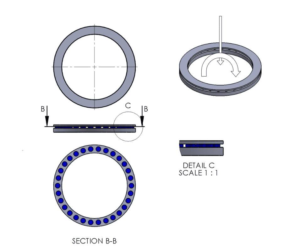

In summary, the design will have two rings with sliding pads fixed on the bottom ring. The top ring slides over the blue pads. The blue pads are made of an plastic with a low coefficient of friction. The axial and moment loads will need to be large enough to keep the bearing in place, but once that is the case the pressure on the pads will be acceptable.

I have a mathematical question for you. I'm trying to design a thrust bearing that can withstand axial and moment loads. I've added a picture of a similar design. The design consists of two rings (grey) and sliding pads (blue) fixed on the bottom ring. The top ring slides over the blue pads. The blue pads are made of an plastic with a low coefficient of friction. I would like to calculate the required force needed for the bearing to turn. therefore I need to know the force acting on the individual pads. I would also like to check whether the pressure on the individual pads will be acceptable.
The axial load will need to be large enough to keep the bearing in place. But once that is the case the moment load will put an extra force on the pads on the right side of the bearing and relieve the pads on the left. I trying to find any formula's that could help me solve this issue but sofar I haven't been able to find suitable information regarding this issue.
I hope there are people out there that can help me a bit further! I there are any question I will be happy to answer those!

Silly question , but why is there a moment? Is the shaft not constrained along its axis.
not a silly question, the shaft is not constrained along its axis. Also, the shaft is extremely short, the length of the shaft is the same as the diameter of the bearing
If the shaft is not restrained radially, will there be a problem of keeping the two rings in alignment with each other?
Also, can you show us a detail drawing of the most heavily loaded segment (plastic pad on the right) with load vectors as you see them on this one pad.
Hi Azfireball,
this is a simplified version of the final design, in the final design the rings will be radially constrained, but it will be done in such a way to have no effect on the loads previously presented.
below I edited the drawing to have a crosssection of the heaviest loaded pad. The forces will be perpendicular to the pad. Does this answer you questions?
Is the bottom plate stationary (Fixed in position?)
Are the rub segments fixed to the lower plate?
Are the aspect dimensions (height to width) of the rub segment accurately depicted in the new rub segment detail drawing?
