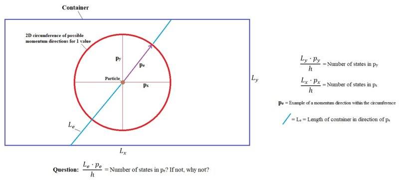

A question came up about deducing the number of possible energy states within a certain momentum ##p## using momentum space.
To make my question easier to understand, I deliberately chose ##p## and not a particular increment ##dp## and I assume a 2 dimensional momentum space with coordinates ##x## and ##y##. The concerning particle thus only has translational kinetic energy in these 2 coordinates.
A particle within a box of volume ##V## can have the same momentum ##p## in different directions within that box. In a 2D momentum space this momentum ##p## is therefore given by a circle with radius ##p##.
From what I understand, the number of possible energy states ##N_s## in this 2D case is then deduced from the area of the circle multiplied by the number of energy states in the ##x## and ##y## coordinates:
$$N_s = \frac{L_x \cdot p_x}{h} \cdot \frac{L_y \cdot p_y}{h} \cdot \pi$$
Where ##L## is the length of the box in a certain dimension (given by subscript ##x## or ##y##).
Here's my question regarding this formula:
I can see that the formula assumes that the density of energy states is homogenous over the circular p-space because it is merely multiplying the number of energy states in the ##x## dimension by the number of energy states in the ##y## dimension. However, I don't understand why this is the case, because from what I know, the number of possible energy states in a certain direction is proportional to the length of the box in that very same direction. If a certain momentum has a combined ##x## and ##y## direction, shouldn’t the number of possible energy states within that momentum vector be dependent on the length of the box in that same direction and not by the ##x## and ##y## coordinates seperataly?
Perhaps a better alternative way to formulate my question is like this:
Why is the number of possible energy states independent of the shape of the container? Why is it merely dependent on the number of states in only 3 perpendicular container dimensions while a momentum vector can be directed at any direction within the container?
Shouldn't the length of the container in that same direction as the momentum vector also determine the number of energy states in that direction?

Does this imply that, for a momentum vector which is a combination of these ##x,y## coordinates, the number of states within that momentum vector is dependent on the length of the container in that same vector direction? I have illustrated my question (in 2D momentum space) to show what I mean:
Correct.
So in your picture the steps in the x-direction are smaller than in the y-direction.

So you get a red ellipse in n-space (3D: ellipsoid) instead of a red circle. (for counting, we usually make use of the n-space).
In p-space you do have a circle, but there the grid point density differs per Cartesian axis.

Correct.So in your picture the steps in the x-direction are smaller than in the y-direction.
Let me restate my question to make sure it came across clearly. Does this mean that the number of states in ##p_e## shown in my picture is dependent on the cross-sectional container length ##L_e## shown in the picture (the diagonal light blue line)?
You are mixing up p-space with x-space. ##L_e## lives in a different world than ##p_e##.

You are mixing up p-space with x-space. LeLeL_e lives in a different world than pepep_e.
Yes, I am indeed aware that they are in different worlds. But my question is about the relationship between these 2 worlds formula-wise (relationship between ##n## and ##L## according to the mentioned formula). The number of states in momentum vector ##p_x## is dependent on the length of the box in the x-coordinate ##L_x##, since the momentum ##p_x## is also directed in the ##x## direction, right? In that case, why isn't the number of states in momentum vector ##p_e## dependent on the length of the box ##L_e##?
Ah, maybe I get it: For a given direction of ##p_e## you have
the number of states in the x-direction = ##\displaystyle{2L_x p_{e,x}\over h} ##
and in the y-direction = ##\displaystyle{2L_y p_{e,y}\over h} ## .
So in n-space you get ##n_e = \sqrt{n_x^2+n_y^2} = \displaystyle{2L_e p_e\over h }##.

Yes, this is indeed what I was wondering. However, shouldn't the number of states in the ##x## and ##y## projection of ##p_e## in that case be dependent on the projection of length ##L_e## in those coordinates (##L_{e,x}## and ##L_{e,y}##), not the full ##L_x## and ##L_y## of the container? After all, the shape of the container could be so irregular that ##L_e## does not have any relationship with the ##x## and ##y## dimensions of the container.
For example, the number of states of ##p_{e,y}## would be ##\frac{L_{e,y} p_{e,y}}{h} = n_{e,y}##

JohnnyGui said:
shouldn't the number of states in the ##x## and ##y## projection of pepep_e in that case be dependent on the projection of length ##L_e## in those coordinates (##L_{e,x}## and ##L_{e,y}##), not the full LxLxL_x and LyLyL_y of the container
No. The number of states is dependent on the projection of ##p_e## only. The distance between allowed states for ##p_{e, x}## depends on ##L_x## - idem y.

No. The number of states is dependent on the projection of pepep_e only. The distance between allowed states for pe,xpe,xp_{e, x} depends on LxLxL_x - idem y.
Ah, this is what I can't seem to grasp. According to your statement this means that:
$$n_e = \sqrt{\frac{2L_x \cdot p_{e,x}}{h}^2 + \frac{2L_y \cdot p_{e,y,}}{h}^2} = \frac{2L_e \cdot p_e}{h}$$
However, the length of the container in the ##L_e## dimension can be any size, regardless of how large ##L_x## and ##L_y## are, which can lead to the equation falling apart (in the case of a weird shaped container for example). The same goes for if the particle is near one of the walls of the container, in which case the ##L_e## length of the container would change as well. Is there a way to explain why these cases don't matter?

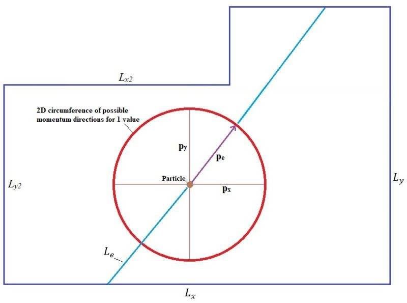

How so ? It's always between Lx and ly.
Note that x and y are fully independent: we solve for each one completely separately.
Something like this for example:
However, since you said ##L_e## should be always between ##L_x## and ##L_y##, does this mean that the largest dimensions of an irregular shaped container are chosen for the calculation?
If the answer is yes, doesn't the number of states in a momentum vector also depend on the direction of a momentum vector and the location of the concerning particle within the container? For example, momentum ##p_y## in this case is confined within length ##L_{y2}## and not length ##L_y## of the container.
You'll have a hard time finding solutions for the Schroedinger equation in this funny case !

Does this mean that the formula is only valid for symmetrically boxed containers, since the number of states within a momentum vector does depend on the length dimension in which the momentum is directed at, such as in the case of my last irregular shaped container?
Bear in mind that these boxes are highly artificial. They are only used to unearth features that scale nicely (e.g. density per volume). The direction of a momentum isn't all that relevant.
The number of states with ##|p| \le ## a given momentum depends on direction also in a symmetrically boxed container. We've been through that, haven't we ?

Yes we have. But what I find very peculiar is that ##L_e## is represented by ##L_x## and ##L_y## instead of its projections, even in a symmetrically boxed container. Let's put the particle at the very upper left corner within the symmetrically boxed container (in my first post). In that case, ##L_e## would be very short. How can the equation for ##n_e## represented by the constants ##L_x## and ##L_y## then still hold for a changing ##L_e## that changes with particle position?
The origin of all spaces is in the 'center'. Don't mix up n, p and x space

Just to make sure I understand this correctly, based on this explanation and your mentioned formula:
$$n_e = \frac{2L_e \cdot p_e}{h}$$
Does this mean that for a particle at any location within the container, to calculate the number of states within a momentum in a random spatial direction, ##L_e## would be the spatial length of the container in that same spatial direction but intersecting the center of the container?

I see. In that case, is the remainder of my statement then correct based on your explanation and formula?
"To calculate the number of states within a momentum in a random spatial direction, ##Le## would be the spatial length of the container in that same spatial direction intersecting the center of the container"
