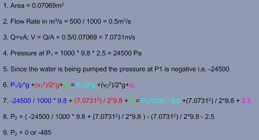

Hello all
I am struggling to calculate the pressure at a given point, i am getting all sort of strange answers and i was hoping someone could help.

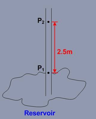

The question is as follows:-
From this i have tried to draw a sketch of the problem (not sure if its correct though):-
I have tried to use the formula Q = vA and Bernoullis principle to calculate the pressure at P2 by doing the following:-
But i have been told that this is incorrect and the correct answer is -49.5 kN/m^2
Because the pressure and velocity at P1 is 0.
I was wondering if i could get someone elses view?
Thank you.
P1 should not be situated inside the pipe. It should be situated at the reservoir surface, at its interface with the atmosphere.

View attachment 254526I have tried to use the formula Q = vA and Bernoullis principle to calculate the pressure at P2 by doing the following:-View attachment 254527
Thank you.
How did you manage two alternative answers? The equation is 1st, not 2ne, order!
Also of course see post 2.
