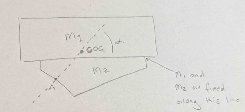

Not homework but a work problem. I would like to find a formula to solve the below problem.
I have two masses, M1 and M2, which are located one above the other.
M1 position is fixed. I need to find the position of M2 so that a line from an arbitrary point, A, on M2 will intersect the COG of the combined masses at a nominated angle.
See illustration.
As M2 moves around the combined COG will change.

Ok, so if you take the lower left corner of M1 as the origin, and the mass centres are at ##(x_1, y_1), (x+x_2, y_2)##, and A is at ##(x+x_A, y_A)##, what equation can you write for the tangent of the angle?
What do you call a "nominated angle"?
What does that note "masses fixed along this line" mean?
I had the same question but I think it means "predefined". It is angle ##\alpha## in the drawing.
At least to me, it is not clear whether mass m2 slides along the bottom surface of mass m1 or pivots about a line perpendicular to the paper.
I think it slides along the bottom surface. That's how I interpret the note in the drawing "##m_1## and ##m_2## are fixed along this line."
Correct. M2 slides along the bottom surface of M1.
The angle is something that we input, not a value to be determined. It ranges from 30 - 60 degrees.
haruspex said:
Ok, so if you take the lower left corner of M1 as the origin, and the mass centres are at ##(x_1, y_1), (x+x_2, y_2)##, and A is at ##(x, y_A)##, what equation can you write for the tangent of the angle?

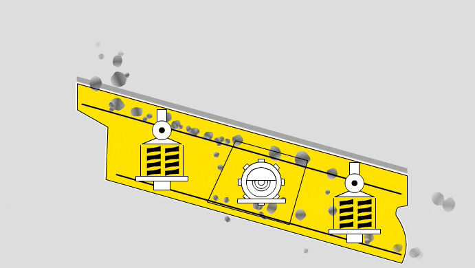

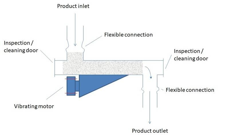

Does the machine look something like these?

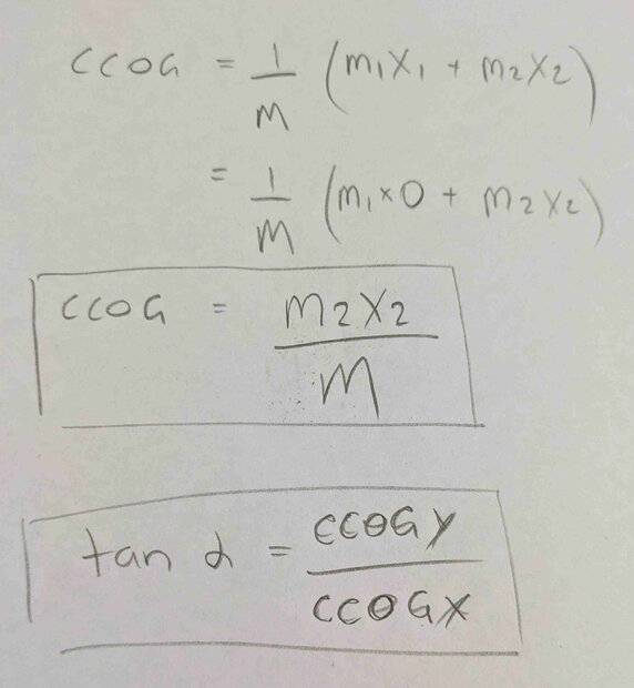

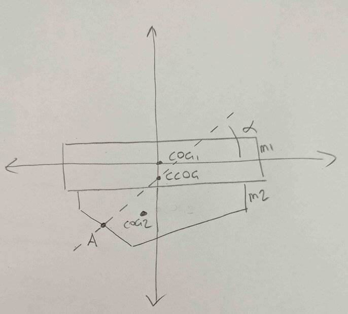

I've reworked the diagram to make the origin at the COG of M1. This works well with the software that I am using and simplifies the CCOG (combined COG) formula.
I now have the two formulas for CCOG. If I combine them they still have two unknowns (CCOGy relates to CCOGx). I need a third formula which relates the COG2 with A. However I can't work out how to connect them all.
I've had an attempt using vectors rather than coordinates with some success but I don't think the solution is a simple point in space. I believe that the solution is a line where M2 can be positioned for the angle constraint to be true.

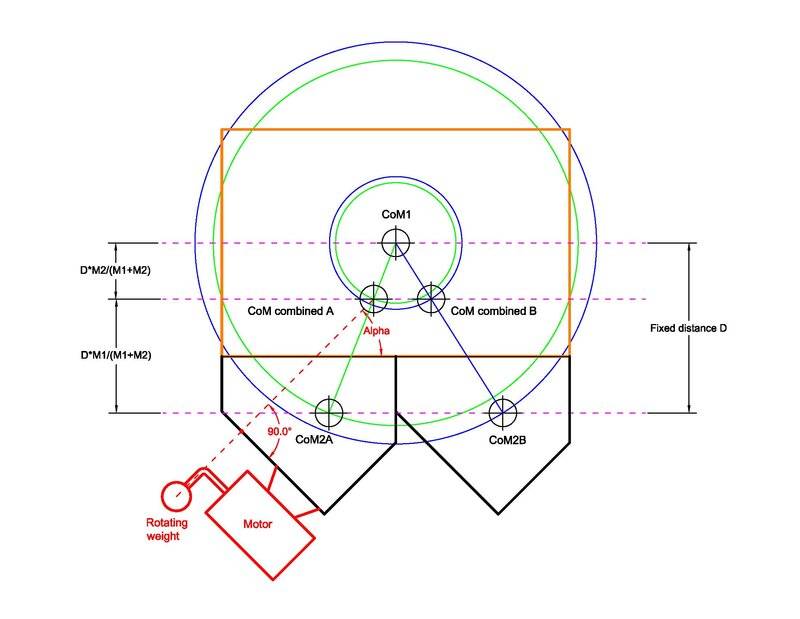

Like this one. The motor angle is simplified in this diagram.
slobberingant said:
Very. These are modeled up in CAD.
Then, you can see that the locations of the center of masses 2 and combined move along lines that are parallel to the common surface.
Regardless the angle, the proportion of distances follows the proportions of masses.

slobberingant said:
View attachment 349048View attachment 349049
CCOG must lie on the straight line through COG1, COG2.
Are your X1, X2 vectors or just the x coordinates? If the latter, you need the equivalent for the y coordinates.
Presumably you know where COG2 is in relation to M2, and where A is in relation to M2, so you should be able to figure out where A is in relation to COG2.
I have no idea how you get that equation for ##\tan(\alpha)##. The formula should involve the coordinates of A relative to the CCOG.
@slobberingant, we have ##m_2## at ##(0, 0)## and ##m_1## at ##(x_1, y_1)##. We know ##y_1##.
With (X, Y) the coordinates of point A, the line through A, making the desired angle ##\alpha## with the x-axis, has equation (point-slope form):
##y -Y = (x-X) \tan \alpha##.
If you have expressions for the x and y coordinates of the combined CoG, you substitute them into the above equation. You are then left with a single equation with only one unknown, ##x_1##.
Edited - mainly because I'd mixed up masses 1 and 2.
Thank you all very much for the answers! I think I have it worked out.
With some external help, moving the origin to the COM of m2 simplified the formula (as alpha was relative on this) and made it understandable.
