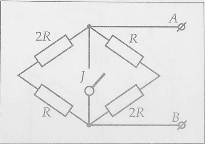

Calculating the resistance when the switch is off
In summary: Well maybe You're a bit confused because English is not my native language, so...But I really think that I translated the original question correctly...When the electric chain's switch (J) is on, resistance Rab (from dots A to B) is equal to 80 Ohms.What is the electric chain's resistance when the switch (J) is off?When the switch J is closed, isn't there a direct path from A to B passing right through it? How can the resistance then be 80Ω? Can you confirm the question statement and diagram?

I thought that the resistors are connected in parallel , but my teacher said that when the switch if on resistors are connected in parallel and when it's off it's in series.
Is this true, cause I think it's parallel, because the wires split either way, no matter if the switch is on or not...
Don't know for sure what's the connection type in this chain, so...
:confused: When the switch J is closed, isn't there a direct path from A to B passing right through it? How can the resistance then be 80Ω? Can you confirm the question statement and diagram?

No, an ideal switch and wires have zero resistance. The switch will form a short circuit, and ALL of the current will pass through it. So, either the text is wrong, or there is more to this problem than has been stated. Is the switch non-ideal with some resistance of its own? Could it be that the switch should really be oriented horizontally across the circuit rather than vertically?

No one knows, because you have got the diagram wrong, kakadas. As gneill observed.

I agree with the other posters. The original question, the diagram and your teachers comment are all inconsistent with each other.
Can you scan that page of the book?
PS Are you sure the switch shouldn't be between the other two corners of the square?

Here's the Photo of the chain from my book:
I really hope someone will answer my questions.

Any factor in the numerator with a zero value will result in total zero resistance.
According to the diagram, RAB must be zero when the switch (j) is closed (on).
Is it possible that there is a language confusion regarding the switch positions? "closed" or "on" means that the contacts are touching and current can flow. "Open" or "off" means that the contacts are not touching and current cannot flow --- open circuit.

Yes the current flows when the switch is off (open) --- It then must flow through the resistor network. But your problem statement contends that the resistance is 80 Ohms when the switch is closed (on). That is not possible with the given information.
I agree. Looks like ON and OFF may have been confused but...
If it's 80 Ohms with the switch OFF (open) that would allow R to be calculated but when the switch is ON (conducting) the equivalent resistance is ZERO.
The teachers comment about it changing from serial to parallel depending on the switch position makes no sense.

With the switch OFF you have two resistors in series, in parallel with, two resistors in series.
With the switch ON the resistors are irrelevant. All the current flows through the switch. You could replace the resistors with ones that were much bigger, much smaller, or a short circuit and it would make no difference. The equivalent resistance is zero Ohms.

http://imageshack.us/a/img688/1161/14883781.png 'As others said, there are errors in the data and in the drawing.
It is waste of time computing on it.
I guess the problem meant for Wheatstone Bridge.

As it is drawn the resistance of the network must be zero with the switch closed.
The only way the resistance can be 80 Ohms with the switch closed is if there's some other resistance hiding somewhere, such as internal resistance of a voltage source (which is not shown), or if the switch itself has resistance. Without knowing specifics the problem is not solvable.
