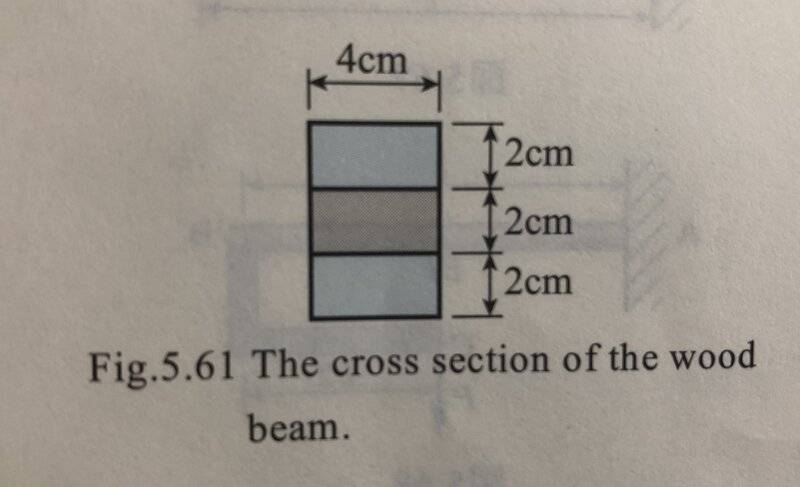

A laminated wood beam made up of three 2cm*4cm plates glued together forming a rectangular cross section that is 4cm*6cm is given. The allowable shear stress in the glued joints is 5MPa. The beam is 10cm long and simply supported at both ends.

For your beam and the related moment and shear force diagrams, shear force acts along the whole beam from 0 to L, with the shear force changing direction at the point of application of the load point P in the centre of the beam.
A shear stress is set up on a face of cross section of the beam in the y-direction. Correspondingly, to make the beam statically in equilibrium, also in the x-direction. For a location y from the central axis, a cube of dimensions dx dy dz would have shear on both opposite faces being equal in magnitude.
For your beam, on this face of cross section, where does the maximum shear stress apply?

Thank you very much, I was able to get the correct answer!
I finally realised that the maximum shear stress applies at y=0, but the shear stress provided is for the glued joints at y = 1cm, therefore I can't just use the equation for maximum shear stress.
