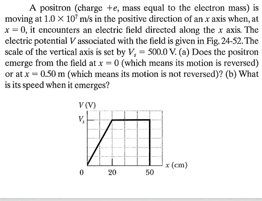

A positron (charge +e, mass equal to the electron mass) is moving at 1.0 X 107 m/s in the positive direction of an x axis when, at x = 0, it encounters an electric field directed along the x axis. The
electric potential V associated with the field is given in Fig. 24-52. The scale of the vertical axis is set by Vs = 500.0 V. (a) Does the positron emerge from the field at x = 0 (which means its motion is reversed) or at x = 0.50 m (which means its motion is not reversed)? (b) What is its speed when it emerges?

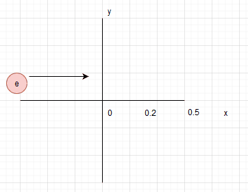

My attempt, pictorially it looks like
I am confused with the questions (a). Does the positron emerge from the field at x =0? There is no potential at x=0, so the positron will continue with the same speed hence its motion is not reversed.
For the (b). The maximum volt is 200V, if i apply the Ui+Ki = Uf+Kf;
0.5*mp*v_ini^2 = 500*e + 0.5*mp*v_fin^2; mp -> mass of proton, v_init = 1*10^7m/s
0.5*1.67*10^-27 * 10^14 = (500*1.69*10^-19) + (0.5*1.67*10^-27*V_fin^2)
Solving for V_fin = 9.9*10^33 m/s; The positron continues with this speed. Even the constant potential of 500V is applied continuously from 0.2m to 0.5m why the speed is not decreasing? Please advise.
It does not mean immediately. It is asking whether the positron makes it through or gets reflected somewhere along the field.
