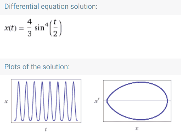

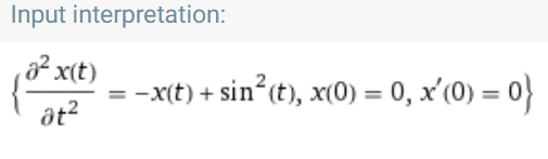

My DE class is 4 decades back, so I use wolframalpha and type in
Code:
d^2x/dt^2 = -x +sin^2(t);x(0)=0, dx/dt(0)=0
and they come back with
which looks OK, and a 'solution'
which I don't fully grok now (late and Heineken), but maybe will tomorrow. They even show a plot (for periodic bumps):Advantage: gets you started and easy to re-introduce some damping
