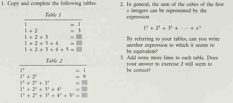

filling in the boxes is easy, 1,3,6,10,15
second is just squares of that,
1,9,36,100,225
But how I anyone supposed to find and expression for this?
This is from a textbook on elementary algebra, the specific chapter is for solving equations where the variable appears on both sides....
I don't see how you could find an expression with any of the material that has been covered thus far.
I did manage to find an equation for table1, (.5)x2+(.5)x using some trick from kinematics
but it will not work for table2.
So how are you supposed to find an expression for table 1 and 2?
Likes OmCheeto
Notice that the sums for the second table can be obtained by adding the numbers that are being cubed, and then squaring that number. IOW, for the sum of the cubes of the first k integers, the sum will be ##(\sum_{n=1}^k n)^2##. Can you work with that to come up with a more simplified expression?
Likes mcastillo356, jim mcnamara, SammyS and 2 others
Not really. ((.5)x2+(.5)x)2 Is all I got. But that requires having that equation already, which I still don't get how the book expects you to figure that out, because the way I did certainly isn't it. And while I know what summation notation it is hasn't been covered in the book yet eighter.
Likes OmCheeto
##((.5)x^2+(.5)x)^2## is the same as ##(\frac{x(x + 1)}2)^2##. Does your book show you how to get a formula for ##\sum_{k= 1}^n k##? IOW, for ##1 + 2 + 3 + \dots + n##? That sum is ##\frac{n(n + 1)}2##.
To get a formula for the sum of the cubes of the first n integers, look at the pattern you've developed for the results of Table 2.
##1^3 = 1##
##1^3 + 2^3 = 9##
##1^3 + 2^3 + 3^3 = 36##
and so on.
The pattern seems to be "add the numbers being cubed, and then square that result." Does this pattern hold for longer sums?

I think everyone is missing what the question is looking for.
You have noticed that the numbers on the RHS of Table 2 are the squares of the numbers on the RHS of Table 1. The answer to question 2 is simply to write this down: ## \left ( 1 + 2 \, + \, ... + \, x \right )^2 ##
Likes John3509 and mcastillo356

Yes of course, but according to the OP this question is presented at the very beginning of an algebra course before any of this has been studied. The question is not looking for a closed form solution, it is looking for the answer I gave in #6:
