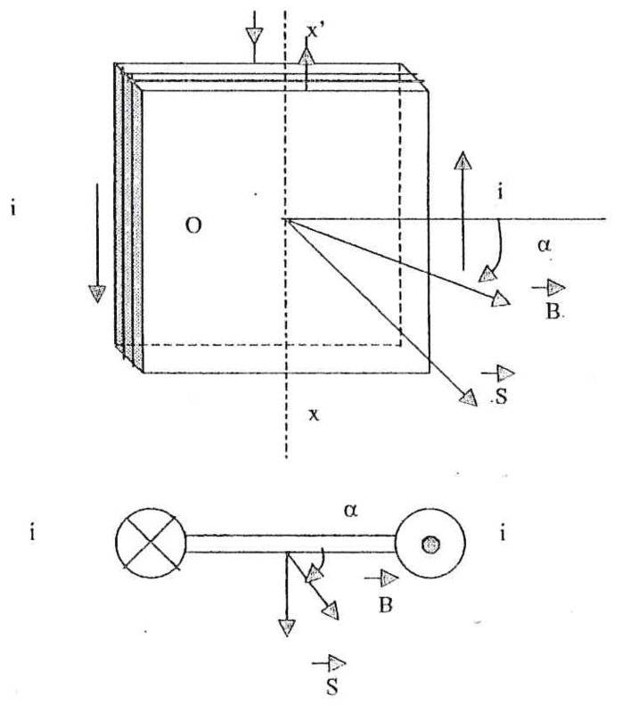

A non-deformable movable frame with square sides ##a = 30## cm has ##N = 20## spires with an electric current ##i = 5## A flowing through them. The frame is placed in a magnetic field ##\vec{B}##, with ##B = 0.4## T where the field lines make an angle ##\alpha_{i}## with the plane of the mobile frame.
What is the moment (torque) of the couples ##C_i## of the electromagnetic forces in the rotation axis ##x\prime Ox## for the four proposed values ##\alpha_i = \{0, \frac{\pi}{3}, \frac{\pi}{2}, \pi\}##?

We first determine the Laplace force for each value ##\alpha##.
$$F_{\alpha} = 5(0.3)(0.4)\sin(\alpha) = 0.6\sin(\alpha) \ \text{N}$$
We then calculate the torque at angle ##\alpha##.
$$\tau_{\alpha} = \frac{a}{2} F_{\alpha} = 2.5 F_{\alpha} \ \text{N.m}$$
Then we just plug in ##\alpha## and we should three different values (since ##\sin(0) = \sin(\pi) = 0##). But I don't understand why the numbers of spires/coils is noted here, I have the notion that the strength of the electomagnetic field is proportional to the number of coils but we haven't reached that point in class, yet. The teacher I have is very poor when it comes to correcting questions, let alone explain them. Can anyone help me understand?

What force is this? Is it the force acting on some particular part of the square? If so, which part?
What torque is this? Have you obtained the net torque due to all of the forces acting on all of the straight sections of wire? It is important to draw the direction of the force on each section of wire if you are going to get the correct expression for the torque about axis ##xOx'## due to the force.

Could you explain where that "2.5" came from? Isn't [itex] a = 0.3 \ \mathrm{m} [/itex] here?
The number of turns in the coil do affect the forces, and thus the overall torque. For example, if you had two current carrying wires right next to each other, together they would (together) produce twice the force of a single current carrying wire, all else the same (same current in the each, single wire; same magnetic field, etc.) Each section of wire contributes its own force.
Also, if you are meant to calculate the total torque, don't forget that not only do you have [itex] N [/itex] current carrying wires on one side, but also another [itex] N [/itex] current carrying wires on the other side of the frame (carrying current in the opposite direction).

I'm not familiar with the use of the word "spire" in this situation. I'm assuming you mean "loop" or "turn" of the wire in a coil. But that's an assumption on my part. If I'm incorrect here, I apologize. It might be a translation thing.
Also, I'm not quite sure how to interpret the meaning of "Couples [itex] C_i [/itex]." Does that represent a single section of wire of length [itex] a [/itex], or instead a single loop of wire?
Also, I'm not quite sure how to interpret the "rotation axis [itex] x'Ox. [/itex]" I assume that means the axis of rotation goes through the center of the loop, parallel to the plane of the loop.

My apologies it's ##\frac{0.3}{2}=0.15 \ \text{m}##.
