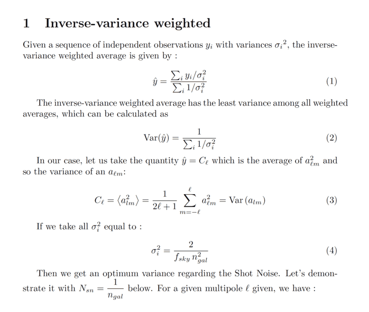

To compute the Poisson Noise of each ##a_{\ell m}^2##, a colleague suggests me to take only the quantity :
##\dfrac{2}{f_{sky}\,N_p^2}\quad(2)##
and to do the summation to get the variance of Poisson Noise (to make the link with formula (1) and be consistent with it) :
##\text{Var}(N_{p,int})=\sum_{\ell=1}^{N} \dfrac{2}{f_{sky}N_{p}^2}\quad(3)##
I wrote above ##\text{Var}(N_{p,int})##, make caution, this is just to express the "integrated Poisson variance" over ##\ell## in the quantity ##\sum_{\ell=1}^{N} \sum_{m=-\ell}^{\ell} a_{\ell m}^{2}##.
Unfortunately, when I do numerical computation with this variance formula ##(3)##, I don't get the same variance than with another valid method.
Correct results are got by introducing a factor ##\sqrt{2\ell+1}## into formula (3).
But, under the condition this factor is right, I don't know how to justify it, it is just fined-tuned from my part for the moment and it is not rigorous I admit.

As a general comment, there is a lot of terms in here that you haven't defined. I know you have a lot going on from reading your post, but is there a paper or thesis that summarizes the measurement and noise sources? Just send us a link or even a citation and we can take a stab at it. It's really hard to make conjectures about expressions when we don't know what they mean.
Your equation 1 doesn't make a lot of sense because it looks like the two noise terms are adding linearly, not in quadrature. Was there a typo?
I'm confused how you get ##\mathrm{Var}(N_{p,int})=\sum_l \frac{2}{f_{sky}N_p^2}## from your equation 1. I get ##\mathrm{Var}(N_{p,int})=\sum_l \frac{2 N_p^2}{f_{sky}}##. It seems very weird to me because I would think that the variance should grow, not shrink, as your poissonian noise term (##N_p##) grows. Did you perhaps normalize by the average squared (##N_p^4##)?
@Twigg, oh , really sorry, I made a mistake regarding the Poisson noise : actually, this is ##N_{p}=\dfrac{1}{n_{g}}## with ##n_{g}## the density of galaxies.
So, my initial formula (3) should be rather : ##\text{Var}(N_{p,int})=\sum_\ell \dfrac{2}{f_{sky}}N_p^2##
##=\sum_\ell \dfrac{2}{f_{sky}}\,\dfrac{1}{n_g^2}##
The lower threre are galaxies, the larger the Poisson noise is.
Thanks for your patience.
Ok! I think that makes more sense! The physics of it is still lost on me but now I think the statistics makes more sense.
Equation 1 still seems like a typo to me. I'm going to assume what you mean to write was $$\sigma^2(C_l)(l) = \frac{2}{(2l+1)f_{sky}} \left( C_l^2 + N_p^2 \right)$$
Let me know if I'm wrong about this.
Given that modification, then I think your introduction of ##\sqrt{2l+1}## in your equation 3 makes sense. Here's what I derived: $$Z = \sum_l \sum_m a_{l,m}^2 = \sum_l (2l+1)C_l$$
Now if we ignore the ##C_l^2## term in equation 1, and just calculate the variance of Z due to poissonian noise (let's call that ##\sigma (Z_p)## to distinguish it from the total variance of Z), then we get:
$$\mathrm{Var} (Z_p) = \sum_l (2l+1)^2 \times \left( \frac{2}{(2l+1)f_{sky}} \right) N_p^2 = \frac{2}{f_{sky}} \sum_l (2l+1) N_p^2$$

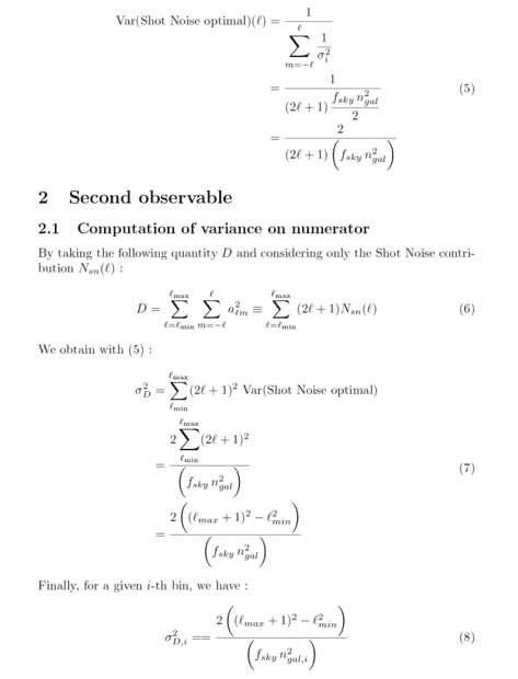

@Twigg . Thanks for your support.
Unfortunately, I have already tried your latest expression, i.e :
##\mathrm{Var} (Z_p) = \sum_l (2l+1)^2 \times \left( \frac{2}{(2l+1)f_{sky}} \right) N_p^2 = \frac{2}{f_{sky}} \sum_l (2l+1) N_p^2##
and it gives too much high values for ##\mathrm{Var} (Z_p)##.
However, with this formula :
##\mathrm{Var} (Z_p) = \frac{2}{f_{sky}} \sum_l \sqrt{(2l+1)} N_p^2##
I get the expected results. But this factor is just fine-tuned, I don't know, if it is the right expression, how to justify it ?
Best regards

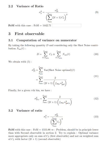

Here additionnal informations about my first method where I am interested in the ratio :
##\dfrac{\operatorname{Var}\left(\boldsymbol{B}_{s p, i n t, i}\right)}{(\sum_\ell C_\ell)^2}##
Indeed, taking the square of (1) for the case ##N_{i j}^{G G} \equiv N_{s p}## make appear cross-terms :
\operatorname{Var}\left(C_{\ell}\right)=\left(\sigma_{C, i j}^{G G}(\ell)\right)^{2}=\frac{2}{(2 \ell+1) f_{\mathrm{sky}} \Delta \ell}\left[C_{\ell}^{2}+2 C_{\ell} N_{s p}+N_{s p}^{2}\right]
and I don't know how to make the connection with ##\operatorname{Var}\left(B_{s p}\right)##.
Maybe I could make the link with the expression :
\operatorname{Var}[X+Y]=\operatorname{Var}[X]+\operatorname{Var}[Y]+2 \cdot \operatorname{Cov}[X, Y]
and do the link with :
\operatorname{Var}\left(C_{\ell}+N_{s p}\right)=\operatorname{Var}\left(C_{\ell}\right)+2 \operatorname{Cov}\left(C_{\ell}, N_{s p}\right)+\operatorname{Var}\left(N_{s p}\right)
But how to prove that :
2 \operatorname{Cov}\left(C_{\ell}, N_{s p}\right)=2 C_{\ell} N_{s p}
?? If this is exact, could I consider ##2 \operatorname{Cov}\left(C_{\ell}, N_{s p}\right)=0## ?
But it remains the term ##\operatorname{Var}\left(C_{\ell}\right) \ldots##
If I could prove it, this way, Maybe we could infer the expression of variance for integrated Shot noise over ##\ell## (noted ##B_{s p, \text { int }}## and ##B_{p h, \text { int }}## ) and with subscript ##i## referencing the ##i##-th bin of redshift :
\begin{aligned}
\operatorname{Var}\left(\boldsymbol{B}_{s p, i n t, i}\right) &=\operatorname{Var}\left(\sum_{j=1}^{N} \boldsymbol{B}_{s p, i}\left(\ell_{j}\right)\right)=\sum_{j=1}^{N} \operatorname{Var}\left(\boldsymbol{B}_{s p, i}\right) \\
&=\sum_{\ell=\ell_{\min }}^{\ell_{\max }} \frac{2}{(2 \ell+1) \Delta \ell f_{\mathrm{sky}}} \frac{1}{\bar{n}_{s p, i}^{2}} \\
\operatorname{Var}\left(\boldsymbol{B}_{p h, i n t, i}\right) &=\operatorname{Var}\left(\sum_{j=1}^{N} \boldsymbol{B}_{p h, i}\left(\ell_{j}\right)\right)=\sum_{j=1}^{N} \operatorname{Var}\left(\boldsymbol{B}_{p h, i}\right) \\
&=\sum_{\ell=\ell_{\min }}^{\ell_{\max }} \frac{2}{(2 \ell+1) \Delta \ell f_{\mathrm{sky}}} \frac{1}{\bar{n}_{p h, i}^{2}}
\end{aligned}
Now, Given the fact that I am interested in the ratio (you can remark the different wieghting with ##(2\ell+1)## on ##C_\ell## :
##\dfrac{\operatorname{Var}\left(\boldsymbol{B}_{s p, i n t, i}\right)}{(\sum_\ell (2\ell+1)C_\ell)^2}##
I was hoping that results being better than with the first method but with the formula of @Twigg , this is not the case.
I don't know what to do, any idea is welcome.
That equation (137) says something different:
$$ \sigma^2 (C_l)(l) = \frac{1}{\sqrt{f_{sky} \Delta l}} \left[ C_l + N_p \right]$$
If your bin width ##\Delta l## is something like ##(2l+1)##, then this will give you the correct factor of ##\sqrt{2l+1}##, but it will mean your denominator will have a ##\sqrt{f_{sky}}## in it instead of ##f_{sky}##. If that number is close to 1, it might not matter.
is there any chance that ##\mathrm{Var}(Z_p) = \sqrt{\frac{2}{f_{sky}}} \sum_l \sqrt{2l+1} N_p## fits the data well?
P.S. I was mistaken in the modification I suggested for your equation 1. The notation made me think it was a standard deviation, but it was supposed to be a variance.
you can look at the reference formula (there is a typo in formula (137) : it misses the factor ##\dfrac{1}{2\ell+1}).##
You can get rid of ##\Delta\ell## factor, it is just the bins width of power spectrum in code and I take it as ##\Delta\ell =1## in my code.

@LastScattered1090 thanks a lot for your long and detailled answer, it is really fine from your part.
I said in the first post that "a colleague suggests me to take only the quantity :
Actually, this is the translation of an optimal variance for Shot Noise from the "Inverse-variance weighted"
method : this is the key point of discrepancy described aboved under image format.
Actually, in my case, I am working with 2 quantities, the first which is the sum of Cl's and the second one which is the double sum on ##\ell## and ##m## of ##a_lm^2##.
I am expected to get a Figure of Merit better with the second observable than with the first one but numerically when I run the codes, it is the contrary, and I would like to prove mathematically or physically why I have this contradicton. Sorry to put images but this is easier than translate all the Latex code in physicsforums format.
Here all the reasoning :
Problematic as you can see : I have a FoM = 1442.71 for the second observable (double sum) and better FoM (1588) for the first observable :
1) Which one of the 2 results is the right one from the optimal variance of Shot noise chosen ?
2) Do you think the optimal variance that I am using in formula(5) is right.
For me, I think this optimal variance for Shot noise is more appropriate for the first observable (just sum of ##C_\ell## without factors ##(2\ell+1)## but I can't for the moment demonstrate it.
Thanks for yout support,
Regards

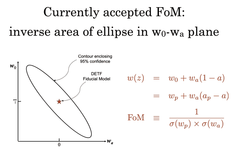

How is your figure of merit defined? I'm used to FoM's for fitting that are better when they are small. Are you defining it like an SNR squared, as in ##\frac{1}{\sigma_o^2}##?
The optimal variance in equation 5 is factored into both observable uncertainties, so that, by itself, won't cause a difference between their FoMs.
Why do you expect the FoM on the second (weighted, as in Eqn 6) observable to be lower? By weighting the shot noise as you do in the second observable, you are giving lower priority to data at lower values of ##l##. Why do you expect a better fit when you're partially excluding data? Is there some reason why the lower spherical harmonic components are noisier? The 8% increase in FoM for the unweighted sum (eqn 7) actually makes sense from the perspective that your weighting was too aggressive.
Edit: Nevermind, it makes sense now. Ignore the section I crossed out. Whoops.
@Twigg . Thanks for your quick answer.
My figure of merit is defined by the inverse of determinant of block 2x2 parameters in covariance matrix (with 2 sigma error).
You say that "it makes sense now" : could you tell me more please about these 2 different results at level of FoM.
Caution, in the 2 cases of computing variance ##\sigma_o^2##, the divider (or denominator) is not the same (see equation (9) and (13) on my images above.
Best regards

now it seems to me like observable 2 is perfectly natural and observable 1 is the one that's arbitrarily weighted. My intuition is that using arbitrary weights is virtually the same as excluding some of the data from the analysis (the data with low weight gets excluded), so I would expect FoM to be worse not better. That is also what I meant when I said "your weighting was too aggressive", you "excluded" too much data.
The main idea is that both observable are equal to a constant. So I am looking for, by computing the variance of the ratio, to get constraints on this ratio.
The first approach (first observable) is to sum the ##C_\ell## at numerator and denominator to get implicitly the average value of ##C_\ell## for numerator and the average value ##C_\ell## for denominator (the number of ##C_\ell## disappears when we do the ratio).
##\begin{gathered}
O=\left(\frac{\mathcal{D}_{s p}}{\mathcal{D}_{p h}}\right) \\
\mathcal{D}_{s p}=\sum_{i=l}^{n} C_{\ell, s p}\left(\ell_{i}\right) \\
\mathcal{D}_{p h}=\sum_{i=l}^{n} C_{\ell, p h}\left(\ell_{i}\right)
\end{gathered}
\begin{gathered}
\end{gathered}##
This method is not an arbitrary weighting : this is just the computation of ratio of average of ##C_\ell##.
I get by this method a Figure of Merit of 1555.88
2) Regarding the Figure of Merit : I am working with Fisher matrix and by inverse it, I get the covariance matrix. I am working into ##w_o## and ##w_a## CDM model.
Here an illustration :
3) with the second weighting :
##O=\dfrac{\sum_{\ell=1}^{N} \sum_{m=-\ell}^{\ell} a_{\ell m}^{2}}{\sum_{\ell=1}^{N} \sum_{m=-\ell}^{\ell}\left(a_{\ell m}^{\prime}\right)^{2}}=\dfrac{\sum_{\ell=1}^{N}(2\ell+1)\,C_{\ell,sp}}{\sum_{\ell=1}^{N}(2\ell+1)\,C_{\ell,ph}}##
I get a Figure of Merit = 1442.71 : this is lower compared to the first observable (the first observable is not really a weighting, just a sum of ##C_\ell##).
I take over yout intuition : with this second weighting, I exclude the low multipoles ##\ell## and increase the importance for high multipoles ##\ell##. So, this fact has an impact on the computation of variance on the ratio, and so on the FoM.
Then, I would like to be able to explain why with the first observable (ratio of mean of ##C_\ell##) gives a better Figure of merit compared to the second observable (ratio of weighting sum of ##C_\ell## with the weights ##(2\ell+1)##, if this is possible from a mathematical or physical point of view.
Hoping this will help you to understand.
Regards.
fab13 said:
@Twigg . Thanks for your support.The main idea is that both observable are equal to a constant. So I am looking for, by computing the variance of the ratio, to get constraints on this ratio.
##\begin{gathered}
\end{gathered}
\begin{gathered}
\end{gathered}##
Regards.

Isn't really there anyone that could help me about a good or natural weighting for my new observable ?
the primordial condition is that the ratio in this observable between numerator and denominator should be equal to the ratio of squared bias of 2 probes. I think that a natural form for this new observable is the ratio
between the sum of both angular power spectrum :
\begin{gathered}
\end{gathered}
It gives for instant the best result from a Figure of Merit point (FoM) of view.
Another form has been suggested but less efficient at FoM level :
The motivation of this second form was to say that for numerator and divider, we adda huge number of chi2 distribution, so we tend to get a gaussian PDF.
\begin{align}
Z&\equiv \sum_{\ell=\ell_{min}}^{\ell_{max}} \sum_{m=-\ell}^\ell a_{\ell,m}^2 \\[6pt]
&= \sum_{\ell=\ell_{min}}^{\ell_{max}} \sum_{m=-\ell}^\ell C_\ell \cdot \bigg( \frac{a_{\ell,m}}{\sqrt{C_\ell}} \bigg)^2 \\[6pt]
&\stackrel{d}{=}\sum_{\ell=\ell_{min}}^{\ell_{max}} \sum_{m=-\ell}^\ell C_\ell \cdot \chi^{2}(1) \\[6pt]
&= \sum_{\ell=\ell_{min}}^{\ell_{max}} C_\ell \sum_{m=-\ell}^\ell \chi^{2}(1) \\[6pt]
&= \sum_{\ell=\ell_{min}}^{\ell_{max}} C_\ell \cdot \chi^{2}(2 \ell + 1). \\[6pt]
\end{align} But actually, I have to compute if there is a gain on the standard deviation for this "almost-gaussian" compared to the sum of ##C_\ell## in the first form.
How to proceed for this computation ? If I manage to calculate analytically the standard deviation of the first and second form, I could compare them and prove basically that the first form of observable is the more appropriate.
Best regards

  • #35
If you have the time, can you also try a third observable? $$D = \sum_l (2l+1) C_l$$. If that gives a FoM equivalent to the second observable, that would at least confirm that the issue is the weighting on different spherical harmonics and that the issue is not correlations between m-channels.
