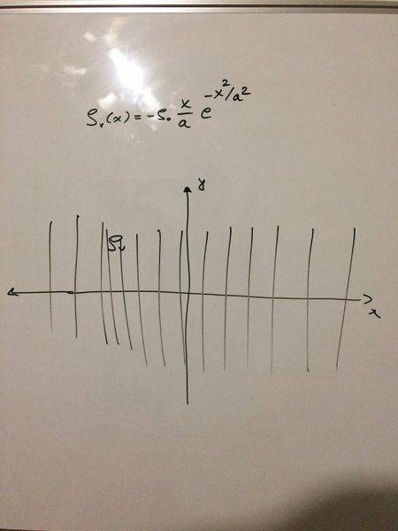

Volume charge density in some space is given by a function ##ρ_v(x)=-ρ_0\frac{x}{a}e^{\frac{-x^2}{a^2}}## where ##ρ_0, a## are positive constants. Determine the electric field vector in arbitrarily chosen point in space.
3. The Attempt at a Solution
[/B]
I find it very important to understand the procedure so I am going to explain what I am doing so you can provide a better feedback.

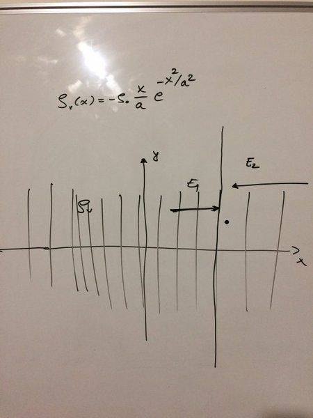

1) I drew a picture that i think suits best
2) I choose an arbitrary point and assign the imagined vector fields that act from each side (i figured that the charge exists everywhere)
I know have an idea how to solve it but don't know if it is correct. I now wrote the expression for calculating the electric field from the left charges in the chosen point by taking the Gauss's surface (a cylinder) and placed in along the ##x-axis## but with one of its sides in the minus infinity.
$$∫E_ldS=\frac{∫ρ_vdV}{ε_0}$$
$$E_l=\frac{\int_{-\infty}^{x}ρ_vdx}{ε_0}$$
So my resutant electric field at point ##x## is equal to:
$$E=E_l-E_r$$
$$E=\frac{\int_{-\infty}^{x}ρ_vdx}{ε_0} - \frac{\int_{x}^{\infty}ρ_vdx}{ε_0}$$
Do you think this is correct?
You do not need to consider the electric field "from each side". When you solve for E at a chosen point using Gauss' law, E will be the total electric field from all of the charge in the system.
That's a good choice for the Gaussian surface. But, when you use Gauss' law for this surface, the symbol E in Gauss' law is the total electric field from all of the charge in the system. That is, E is the total field due to the charge inside the Gaussian surface as well as the charge outside the surface.
OK. But ##E_l## is not the field "from the left". It is the total field at the right end of the cylindrical Gaussian surface due to all of the charge in the system (from x = -∞ to x = +∞).
$$E=E_l-E_r$$
No. From the above remarks, do you see why this is not correct?

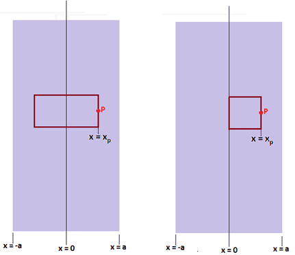

I would place the cylinder as if the ##x-axis## passes through the center of its basses (the circles). And as for the point in the charge system i would now place the cylinder to the left or the right so that its one side goes though the ##x## and one side there where there is no field. Is this right?
$$E=\frac{\int_{-a}^{a}ρ_0dx}{ε_0}$$ for the total electric field at some point outside the system
$$E=\frac{\int_{-a}^{0}ρ_0dx}{ε_0}$$ if the point i want to calculate the field in is ##0##. But it doesn't seem correct for the second part does it? Do i get the field at that point to be 0?

1) For the point outside the charge system:
##\oint E dS = \frac{Q}{ε_0}=
2ES=\frac{\int_{-a}^{a} ρ_0 Sdx}{ε_0}##
This should be the expression for the point outside the charge system, i can't figure out why is not..
And as for the point inside the system, if we choose the point to be some ##x## must the surface be from ##-x,x##? Cant i place the surface from some point in the outside to that point ##x##? And then integrate from ##-a## or ##a## to ##x##?

This is correct. So, what do you get for E in this case?
Yes, you could do it this way as long as you have already figured out E for points outside the charge distribution. If you haven't already found E outside, then I think the two choices for the cylinder that I showed in the diagram would be better choices.

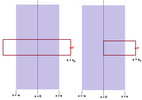

How did you get 2ES? The flux through one end of the cylinder does not necessarily equal the flux through the other end.
Oh, well in that case can i place the one end to be outside where i know the field? Then the right expression remains but i have ##-E_{outside}S## on the right side as well. The original right side when integrated equals the field outside and when it goes to the right side they cancel out. Is that it?
You'll have to show me your argument explicitly "line-by-line". Otherwise, it's too difficult for me to try to interpret what you are saying.

For the point at location ##x=0##
##E_{outside}S+E_{in}S=\frac{\int_{-a}^{0}ρ_0Sdx}{ε_0}##
##E_{in}=\frac{ρ_0a}{ε_0} - E_{outside}##
##E_{outside}=\frac{ρ_0a}{ε_0}##
##E_{in}=0##
##E_{in}=0##
Yes. Good.
