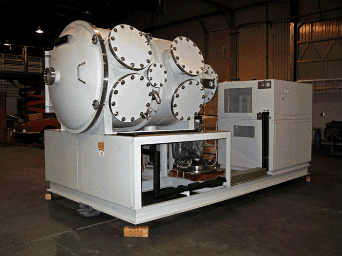

I am designing a cylindrical vacuum chamber and need to calculate the minimum wall thickness to prevent implosion.
I have an inner radius of 0.96 m, an internal pressure of 10^-9 Pa and the external pressure is atmospheric (101,325 Pa). The material has a yield stress of 355 MPa.
Is there any simple equation that can be applied here to calculate the minimum chamber wall thickness? Thanks!
That's deep into the ultrahigh vacuum. You'll need special low outgassing materials, proper welds, expensive pumps, baking of the chamber, copper gaskets, and on and on. This will take a long time to get right and will be expensive.
Likes jrmichler and berkeman
No. If you use search term vacuum vessel design calculations, the very first hit starts of with "External pressure (vacuum) calculations start off more complex than internal pressure calculations, ".
That site also mentions that "The calculations are found in ASME VIII-1 UG-28". The last time I read through ASME Section VIII for pressure vessels, I believed the friend who told me that, in order to properly understand and use it, a person needs to work with Section VIII for a full year under the guidance of somebody who knows their way around that document.
That's in addition to Posts #2 and #3. If this is a real project, get a copy of ASME Section VIII, read it enough to understand that you are over your head, then find somebody that knows how to design vacuum vessels. If this is a homework problem, study your textbook to understand what assumptions and simplifications they are making, then post them along with a request to move this to the homework forum.

The walls don't need to be very thick to prevent an implosion. The reason why UHV system has thick walls has to do with the need to be able to attach windows, flanges etc AND the fact that even solid metal will be somewhat porous to gases such as hydrogen.
Mfb is of course correct that there is no difference between 1 Pa and a nPa when it comes to the risk of implosion. Hence, any container that is designed to be operated below 1 Bar should be strong enough.
If you want to design something that can reach 1e-11 mBar the risk of implosion is probably the least of your concern.
The problem with thin walls is buckling. The cylinder is only strong while it remains cylindrical. For that reason hoops are needed to maintain the surface curvature if the wall is too thin. Any dent or elliptical deformation will cause an unbalance of forces that can initiate a catastrophic collapse.
