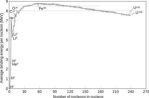

Yes, the mass deficit is a function of the nucleus size, it has maximum value around nuclei containing 56 nucleons. For larger nuclei the binding energy per nucleon becomes lower again (which is why large nuclei can undergo fission).
(image from wikipedia)

Very interesting to read its Wiki page! So I've found the binding energy of a Carbon-12 atom on Wiki which is 92161.753 ± 0.014 keV. I'd assume that this is the energy-mass equivalent to my calculated mass difference.

Guys, I've got a few questions regarding this diagram to make sure I understand it well.
1. Do fusion of atoms that are heavier than Fe require energy as well?
2. Is it correct to say that fusing atoms that are heavier than Fe will not yield any energy? And, if the answer to question 1 is yes, that the given energy to fuse these heavy atoms actually turns into mass and make the nucleons heavier?
3. Can I say that if atoms that are heavier than Fe would fall apart, it will yield energy while if atoms lighter than Fe would fall apart, they would actually need energy? In the latter case (atoms lighter than Fe), the needed energy would be turned into mass and make the nucleons heavier?
4. How can it be that the total released binding energy of a ##^{12}C## atom is 92161.753 keV while the triple alpha process to make a ##^{12}C## atom actually releases 7.367 MeV?
I understand that the triple alpha process goes through more steps but shouldn't the end net released energy be equal to the released binding energy of a ##^{12}C## atom from single nucleons?

I feel like you are in general on the right track, but I don't like this statement. I don't think we can assign mass to nucleons in nuclei, at best we can calculate their average mass.

What if I say that the average mass increases? I'm thinking this because the fusion of atoms heavier than Fe as well as the falling apart of atoms that are lighter than Fe both need energy while at the same time they both result in a lower binding energy release. Doesn't the net energy difference have to be turned into mass or do the newly formed atoms merely possesses more kinetic energy?
I take it that my statements 1 to 3 are more or less correct?

That's what the plot says (even if indirectly).
Yes, you are just using a bit convoluted approach, I am used to think in terms of binding energy, not mass changes (averaged, to make the argument even more difficult to follow).

If you look at the plot, it is obvious that most of the energy was already released when producing He (which is why it is so easy to burn H and produce He, but much more difficult to move further).
