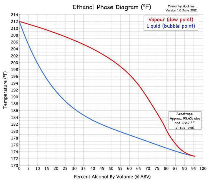

Your theoretical development is way off. What you are dealing with here is a solution of alcohol and water, and when you heat the mixture, both alcohol and water go into the gas phase, and in different proportions than in the liquid phase. So what you are dealing with is the vapor-liquid equilibrium behavior of a binary solution of alcohol and water. The process being considered is distillation. See Treybel, Mass Transfer Operations. Google VLE Alcohol Water. Consider using vacuum distillation to lower the temperature of the operation.
Likes russ_watters, DaveE, pinball1970 and 2 others

If you really want to remove all of the ethanol, you will essentially have to boil the wine. Heat will preferentially remove ethanol, but only to a certain concentration, as shown in the phase diagram below.

I think you are interpreting this wrong. It seems to me you are looking at the wrong side of the phase diagram. If you start off with 15 % by volume of ethanol, the first vapor to come off at 195 F will be 60 % ethanol. If you raise the temperature from 195 F to 202 F and allow the vapor and liquid to equilibrate, you will have lowered the concentration of ethanol in the liquid to 7.5 volume %, and decreased the amount of liquid by only a small amount. This is all at a pressure of 1 atm.
Working with a phase diagram like this is very basic stuff to us Chemical Engineers.

Hum... Now I'm confused. Isn't it true that at 1atm, 202F, EtOH concentration in the liquid can't fall below 7.5% in equilibrium?
Now, if you blew fresh air in you wouldn't be at equilibrium. Does that mean you can reduce the concentration lower, or are you just removing H2O and EtOH in proportion to maintain the same concentration?
Yes, that’s what I said. At 202, it is 7.5% in the liquid.
This diagram is for the binary system water and alcohol; no air.
Oh. Yes you're right, I didn't know that part.
At a basic level, what difference would a bunch of Nitrogen molecules make?
Can you treat vapor pressures separately (non-reactive, of course), like superposition in linear systems?

But if the purpose is to remove ethanol from the liquid why would you maintain the the alcohol vapor eqilibrium??? Take the lid off the boiling pot and let the ethanol diffuse away. Let the volume in the kettle decrease until 11% of the liquid is gone and/or the temperature has reached the value stipulated on the chart Equilibrium neither required nor requested.

Yes, which leads to my next/previous question.
At the liquid-vapor interface, is it always in equilibrium at the molecular level, no matter how much you try to blow fresh air onto it?
