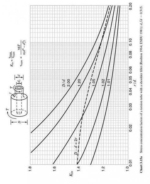

I am designing a custom socket for an application at work and I am concerned about the wall thickness in the area marked by the red box (see attached drawing). The socket will be used to torque a nut to 500Nm.
I have a degree in mechanical engineering and I can do stress calcs on straight forward shapes but I struggle when things get more complex or are composed of multiple shaft sizes and features.
I normally either design big, ignore or pass the work on to a stressman but I would like to understand how to do it myself.
Could someone explain to me the steps you would take to analyse the component to ensure that it will be able to withstand the applied torque?
Thank you very much for your help.
Steve

Hi Steve,
Ordinarily my analysis "order of operations" will go something like this:
  1. First order- Is the part simple enough to analyze via traditional means using analytical equations (e.g. Roark's Formulas for stress & Strain)? If so, I do this and stop (rarely happens).
  2. Second order- Does the part have relatively simple confounding factors such as fillets, notches, or other features that can be analyzed through analytical equations in combination with derived stress concentration factor (e.g. Roark's Formulas for Stress & Strain + Peterson's Stress Concentration Factors)? If so, I do this, and then usually follow up with FEA in case the simplified stress concentration factor missed something.
  3. Third order- If the two above yield no obvious analysis path, best bet is to run an FEA analysis.
In most cases (maybe because I'm spoiled with the software availability) I will likely run an FEA analysis on nearly everything if I'm curious about deformation/stress/temperature, but honestly I'm rarely designing something that can be easily analyzed via Roark's any more. Even in these cases though, it's always a good idea to try and make a simplified analysis through an independent means (like analytical analysis or experimental testing) to see if your FEA model is making sense.
In your case I'd say the design shown probably falls somewhere between 2 and 3, but you might be able to make some assumptions to make an educated guess at where it might fail. Roark's unfortunately only has equations for axially symmetric torsional anslysis, so by itself we can't use it for what you seek. On the other hand it might be possible to use a set of equations from Peterson's Stress Concentration Factors, I looked through my copy of the book and found a table on page 169 (Google Books Link Here, picture attached) which is titled "Chart 3.15a, Stress concentration factors of a torsion tube with a shoulder fillet (Rushton 1964; ESDU 1981)" The geometry pictured isn't too far off from what you're doing, so it might be this could give you your second-order analysis.
Even with the second-order analysis, I'm thinking you'll need to follow-up with an FEA analysis anyway. Usually stress concentration factors for torsion or tension assume a long shaft, so the analysis area is far away from the ends; your design probably won't meet this criteria. Also, you might be incorrectly assuming where the design will fail. Looking at the design, it might fail at the thin wall near your hex wrench flats. An FEA analysis with the right boundary conditions could help you find the weak spots.

At the same time, in order to give you some guidance, I am offering you the below of what appear in my opinion, to be the critical areas of analysis for your tool; however, these should not be considered to be a complete analysis as required by your organization. Regardless of these recommendations, any analysis you perform should be submitted to your organization's "stressmen" for approval.
As for your area of concern, as long as the analysis shows the shearing stress along the shaft is acceptable and there are no bending stresses on the tool shaft then the transition section should be safe as well because it has a smooth radius transition which at any point has a greater effective wall thickness than the rest of the shaft.
At the same time, you should also analyze the driving hex end of the tool. You could use the average of the flat 36 diameter and the points' 42 diameter for that analysis; but, I strongly recommend that you use only the 36 OD for that analysis to be safe. As a general recommendation, unless you need the tool's 32 bore hole through the entire length of the tool in order to insert the tool around a shaft, I would recommend that you consider only drilling a blind end hole from the socket end that stops at a point 40 or more from the hex end to provide a solid center under the hex drive area.

Regarding FEA boundary conditions, if I were doing the analysis I would probably include the parts that this drive socket is interfacing with as rigid (zero deformation, infinite stiffness) solids. Make sure those solids have similar gaps in the interface to what might be expected in the real parts. From there I would apply a torque to the "drive socket" which is driving your hex wrench flats, and apply a fixed condition to the splined part being driven, and maybe a cylindrical support on the part itself to enhance convergence.
Without the mating parts being modeled, your next best bet is applying a 500 N-m moment to the 6 wrench flat faces, and either fixed condition or maybe non-linear "compression only" conditions to one side of the drive splines in your socket. Additionally you'll need some kind of axial constraint (maybe a cylindrical axial-only constraint) to constrain rigid-body motion in the axial direction.
As JBA and I pointed out, I think your failure point will be at the sharp corner at the base of the hex wrench flats where the wall is thinnest. You should consider putting a fillet there. Also, make sure you know what material you're making this part out of, what strength certification is required, and what your acceptable safety factor is. If this part is going to be driven by a high-impact device like an impact wrench, you will want a high safety factor.
