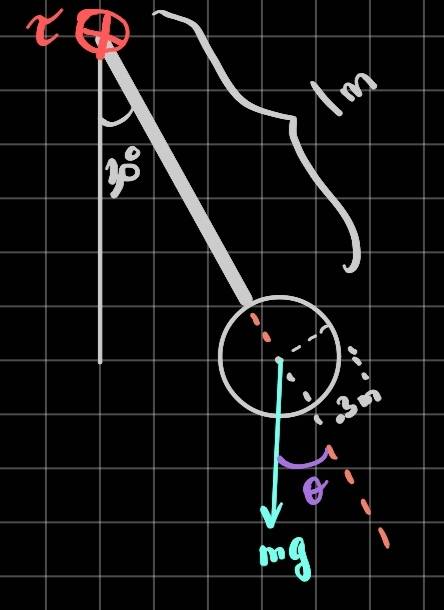

A pendulum consists of a rod of mass 1 kg and
length 1 m connected to a pivot with a solid
sphere attached at the other end with mass 0.5
kg and radius 30 cm. What is the torque about
the pivot when the pendulum makes an angle of
30 with respect to the vertical?
## \tau = -rFsin\theta ##
Let ##m_{r}=1## kg be the mass of the rod and ##m_{s}=0.5## kg be the mass of the sphere.
## = -r([m_{r}+m_{s}]g)sin\theta ##
## =-1.3(1.5)(9.8)sin30 ##
## \tau = -9.6 ##
My book's answer key disagrees and my initial thoughts are that maybe the mass in my calculation is incorrect. Any help is appreciated.

Think carefully about the torque exerted by the weight of the rod.
Well I finally figured this one out after that hint. If anyone comes across this in the future here's a Walter Lewin video that might help
