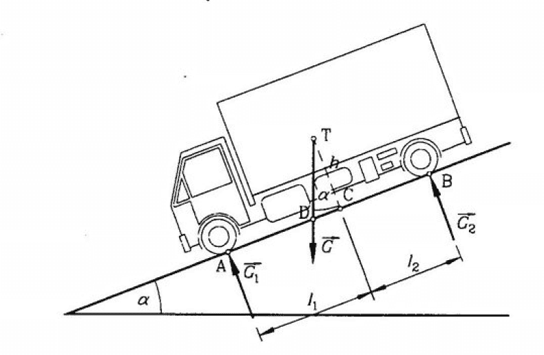

So I was wondering how do we account for vectors that are at a certain angle. The problem that I'm having with the picture is: if I was calculating torque from point B, how would I account for the vector G.
I've tried taking the component that's vertical to the slope, but in that case what is the lever arm? Is it where the vector G crosses the slope(point D)?
