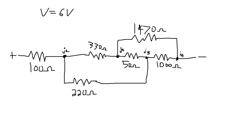

Find the total resistance of the circuit
Parallel resistance: 1/Rtotal = 1/R1 + 1/R2 + 1/R3 + ..., Series resistance: R1 + R2 + R3...
The 1470 ohm resistor is parallel to the 50 ohm resistor and the 1000 ohm resistor, but there is a junction between them, which confuses me on how to add the 1470 ohm resistor to each of them... that probably didn't make sense but it's the best way I could word it. Once that is solved I know how to do the rest.

None of the resistors are in series or in parallel with any other.
How would i go about adding up the resistances then?
Connect the combination to a voltage source V and calculate the current I it draws. The equivalent resistance is V/I.
But to find the current that is drawn from the battery (6V) i need to know the total resistance of the circuit...
You're just going to have to write down equations using Kirchoff's laws and solve the resulting system of equations.
I would perform a Delta to Y transform on the 1470, 50, & 1000, which are currently in Delta (a triangle). See these for info on Delta-Y
http://ux.brookdalecc.edu/fac/engtech/andy/elec111/powerpoint/12_deltatowye.pdf and https://en.wikipedia.org/wiki/Y-Δ_transform
I would think that there is no point to this. You need the total resistance to calculate the current, then use I=V/R, and then go back to use R=V/I. That's just a lot of unnecessary extra steps that you would take after you find the total resistance.
To solve this you would need to either use kirchhoffs laws or kirchhoffs laws with the delta y transform.

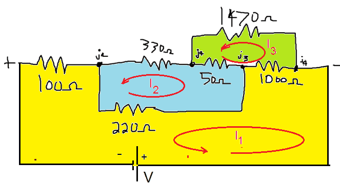

One method is the loop-equation method. Draw out the possible current loops for the circuit, write an equation for each loop, and then solve the simultaneous equations to find each loop current. The sum of these give you the total current for any given source voltage, and from that you can determine the total resistance of the circuit. Here's the circuit redrawn with the loop currents marked:
just out of personal curiosity for my learning
can you do that with just the three loops you have done or should it really be for all loops ?
as there is a 4th loop

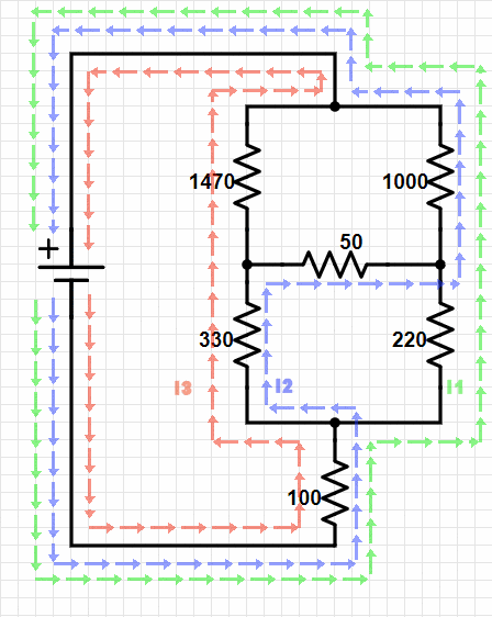

You'd find that only three of the loop equations are independent. The equations from the other loops would be linear combinations of the three.
