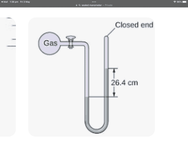

I have a tank that is sealed and completely filled with water. . Half filled the tube with water and sealed one end of it and connected the other to the sealed tank with a u tube arrangement. The sealing of one end of the tube stops atmosphere from pushing down on the water forcing it through the tube when lower pressure is available. A pump will lift water 34 ft when atmosphere can act on the water source. When I start the pump it draws water from the bottom of the tank and will pump out 90% of the water in the tank and the water in the manometer will rise 40 inches on one side while the other side is lowered 40 inches. As the water in the tube is lifted on one side by the vacuum created by the pump the water on the other side is lowered against the vacuum created by sealing the tube against atmospheric pressure. Both sides of the tube are acting based on vacuum.
As the tank is emptied to about 90% of original volume the expectation would be that the total vacuum would be 10% of atmosphere less water vapour created by the boiling of water at lowered pressure. If I’m reading the manometer correctly at 40 inches it makes sense but if we have to double the distance then 80 inches of water doesn’t make sense. The water temp is about 20 degrees celcius so it should start boiling at 59% atm or 240 inch h20.
Asking how the manometer should be read correctly. My manometer is maxing out so will have to put a gauge on the system anyway but would like to know if it’s worth doing or do I need to redesign the pumping system.
If the side of the manometer away from the tank is closed, then there is no way for it to reliably read pressure, since the air pressure on that side will vary. The numbers you are reading from it are meaningless.

You have already been asked to provide a diagram of this set up. Your verbal description makes very little sense. Your diagram should follow the same 'rules' as other diagrams of liquid systems so look at some other examples on Google. I suggest using the 'Images' option.
Seems to be something. Sealed manometers read pressure independent of external pressure

Maybe, but you still need to know the pressure on at least one side in order to interpret the reading. Think about it and label the diagram with the heights and pressures. Can you make them add up?
Note: when people say "provide a diagram", the diagram needs to include descriptive labels/numbers.
Also, where did you get that diagram and what do they have to say about it?
Both sides are sealed at sea level atmosphere (14.7psi ). I’m measuring vacuum created. So the starting pressure is 1 atm and the finish pressure is 40 inches h20 on both sides
Why did you select that particular diagram for an attachment? What does the "26.4cm" represent? The pressure inside the closed portion is given by the total height of the space - not just a part of it. The manometer should start with the tube full. As the test pressure is reduced below AP, the gap at the top will show the test pressure. Are you sure you have understood enough about manometers? Or perhaps you should post a relevant diagram. Does it use water or mercury, btw?
If you are using a partially filled (i.e. with air)space then that air will expand (Boyle's Law) and modify your reading.
But, as I have already pointed out, without a proper diagram of your equipment we can't really help of comment. If you want help then you must make a bit of an effort. Not some random copy and paste from google.
It's not going to work with both sides sealed. You have to know the pressure on one side to find the pressure on the other.

There are lots of manometers that are sealed both sides.
That’s ok but there has to be a known reference pressure that isn’t AP. You have not given a diagram to explain how you do without AP.
Is this ‘thing’ a secret or is it just a vague idea in your head? Help us please.

Fixed I think. Bought a gauge that went as low as -100 kpa and it went well past that and hard up against the stopper at around where the -130 kpa graduation would have been if had been marked. Must have gone well past that level though as when I repeated the test the gauge only got as low as roughly -110 so I’m thinking the gauge was damaged in the initial test or it found a way to admit a small amount of air into the tank , perhaps through the pump seals. Either way it has proven to be more than is required. Thanks for all your input.
