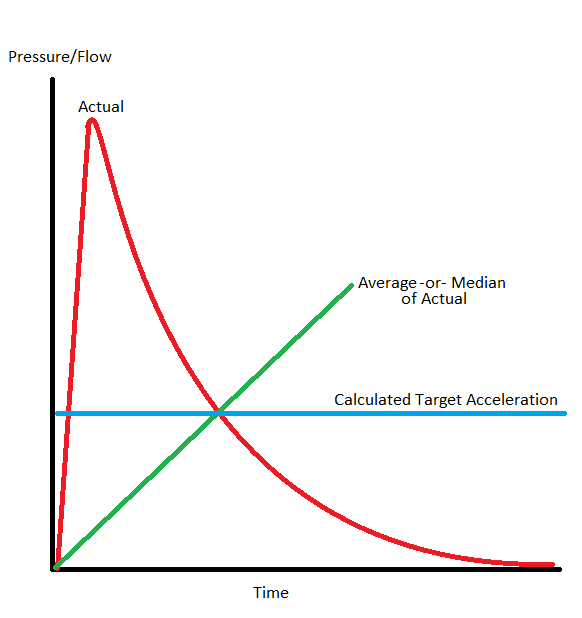

Hello, Hope everyone is doing well.
I have a personal project I am working on and am trying to figure out the nature of the hydraulic system. I want to size a valve to the system properly and have been reading a lot about the Cv value. I don't fully understand how to implement this value into useful information and it may not be relevant to my application because this is a static value, but I will provide an example of my systems operating conditions.
The system will charge to a known value say 3000psi before the cycle begins. Each cycle will have to reach this value before it is allowed to begin.
The system also contains a hydraulic accumulator, I know the discharge volume per 100 psi drop in pressure.
When the cycle begins a logic valve will be vented and open, I can dictate the speed at which it opens but cannot easily meter the valve, it will switch to the fully open position, I can simply delay the open rate.
As the actuator moves the system pressure will drop quickly, the pump will not provide anywhere near enough flow to sustain pressure the accumulator will effectively be the prime mover during this period.
The actuator must be accelerated to a known final velocity over a known displacement, this also provides a known volume of oil that will need to be displaced.
I can also calculate the pressure drop on the supply side of the system if I displace the actuator over a known time.
I am trying to determine what size valve I should use to give me the flow I need to achieve the acceleration required.
I know as my pressure drops my flow will be equally effected, and I know the pressure differential on the valve will also effect flow. Any change in flow will change my rate of acceleration. So I am kinda stuck at this point I think I need a pressure differential to determine a valve size?
I think that ultimately since my acceleration will never be constant I will have to start with a higher acceleration and end with a lower acceleration to get and average acceleration that will provide my final velocity?

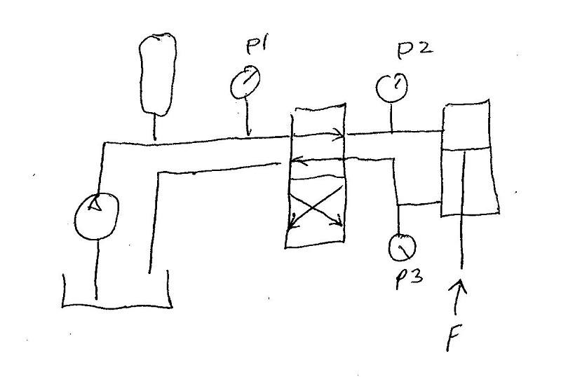

Interesting project, but first, it's time to back up a little. Start with a simplified hydraulic schematic using standard hydraulic schematic symbols. Search term, if needed, is hydraulic symbols. The simplified schematic below is what I think you have in mind:
Second, you need to define the operation:
Are you moving significant inertial mass?
Does the load have a significant friction force?
Does the load have a gravity component?
Does the load include an external force other than gravity?
How far is the move?
What is the required move time?
The valve Cv gives you the pressure drop at any flow rate. The actual calculations are iterative, and require enough computation that you are advised to write a simulation program. This can be done with a spreadsheet. The program is roughly as follows:
1) At start (T = 0), cylinder velocity and position are zero, and valve position is open. Since cylinder velocity is zero, flow velocity is zero, so P1 = P2 and P3 = 0. The difference between P2 and P3 applies a force to the piston. The sum of the forces on the piston causes an acceleration.
2) At time T = T + ##\Delta##T, the velocity is velocity at T + acceleration * ##\Delta##T, and cylinder position is position at T + velocity * ##\Delta##T. Now that you have a velocity and position, calculate P1, P2, and P3.
3) Repeat Step 2 until the cylinder reaches end of stroke.
4) Adjust parameters, such as valve Cv, until the simulated system works as desired.
Make the ##\Delta##T a variable, because you will need to adjust to get reasonable compromise between run time and accuracy. The general rule is start large, then decrease in steps until the answer stops changing. Simple Euler integration is normally good enough for this type of problem.
Unless, of course, the load inertia is low. In that case, the flow is determined by P1 and the valve Cv. Don't forget that the oil flows through the valve in two directions, so you have two pressure drops.

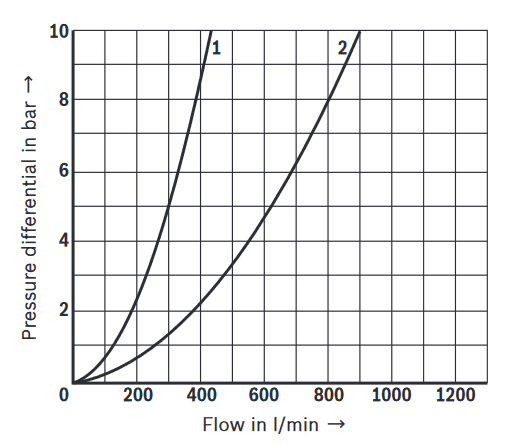

jrmichler, thank you for the reply.
This is not quite the valve configuration I have provided an example below.
The valve will only flow in one direction, using the logic valve circuit will allocate one valve to extend and one to retract on each port, 4 vales total for 2 directional movement. As far as the questions you have listed, the answer is yes on a lot of those, yes it has a gravity factor, yes its a substantial mass 5k lbs, it moves 3 feet, the only external force besides gravity will be the cylinder, it moves very quickly, about .250 milliseconds.
I have already calculated all the forces and flow rates and the gravity into what my final acceleration and acceleration time are going to be. My stuck point is actually finding a valve that will give me the flow I need and because the cycle time is so fast there isn't a way of providing a constant pressure, the pressure will inevitably drop so I need to find the balance point to get my final velocity.
I will certainly look into the spreadsheet, I was actually reading about spreadsheets beforehand but have yet to use one. Where exactly does the delta T fall into the equation? P3 will be negligible as an oversized dedicated valve can be implemented on each side of the cylinder for return.
EDIT*
It may also be worth noting, this is the datasheet providing me with valve selection options, I don't think I can develop a baseline IE a max flow or Qmax at 3000 psi pressure differential.
If you know the; 1. Port size of the accumulator. 2. Port size of the actuator. 3. Peak flow rate. Then you know the diameter of the hydraulic line.
It should be easy to select an appropriate size of valve that will fit.

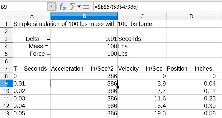

How to do a dynamic system simulation using a spreadsheet.
Simplified example below:
The simulation starts at Time = 0 (cell A8). The time steps are incremented down Column A. The acceleration at each time step is calculated from the mass in cell B4, and the force in cell B5. In your case, you will calculate the force at each time step. The velocity at each time is simply the velocity at the previous time step plus the acceleration at that time step times the Delta T. Example: C9 = C8 + $B$3*B9. Similarly, the position is the position at the previous time step plus the velocity times the Delta T. Example: D9 = D8 + $B$3*C9. You copy the cells down until the position reaches the desired distance. If you use a smaller time step, copy more cells down. Note that this is the simplest possible integration, but it is good enough for this application.
For the numerical analysis types: The above code resulted in 3.4% position error at 0.3 seconds with 0.01 second Delta T, and 1.7% error at 0.3 seconds with 0.005 second Delta T. That's more accurate than the other numbers going into these calculations, so is good enough for this problem. It's also simple and easy to understand for somebody just getting into simulations.
