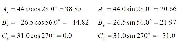

What is the magnitude and angle to
Vector B - 2(Vector A)?
A sub x: 44cos28 = 38.85
A sub y: 44sin28 = 20.66
B sub x: 26.5cos56 = 14.82 <-- (Does the negative sign matter in 26.5? My teacher said it's not)
B sub y: 26.5sin56 = 21.97
I multiplied the Vector A's by two.
A sub x: 38.85 x 2 = 77.7
A sub y: 20.66 x 2 = 41.2
I then solved for the x and y components.
x: (77.7) + (14.82) = 92.52
y: (41.2) - (21.97) = 19.23
Then I solved for the magnitude and angle.
Magnitude:
[itex]\sqrt{}[/itex](92.52)2 + (19.23)2= 94.50
Angle: tan-1 = 19.23/92.52 --> 11.74°
Is this correct? I have a weird feeling that it's wrong. I feel like I am missing something some wear. I really can't tell.
