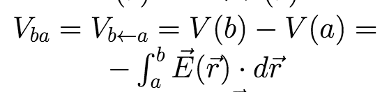

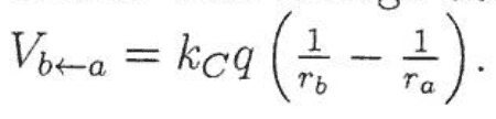

The voltage between any two points due to the field from a point charge q is:
Kirchoff's voltage laws, which states that the total voltage around a closed loop must be zero, i.e.:

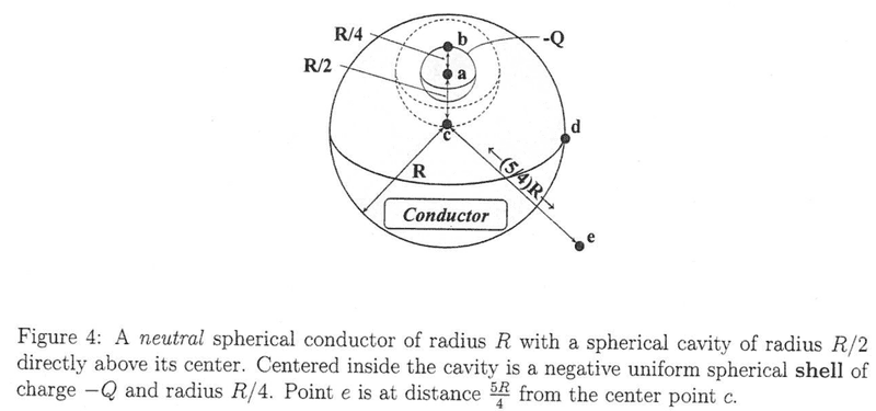

To find V(e<-d) I used Kirchoff's Voltage Law:
To find V(e<-a) I used the fact that you can break voltages into parts:
But I know my answers are wrong b/c this is what the solutions say:
My question is, what is wrong with the way I'm calculating V(e<-d) and V(e<-a)?
How did you get the expression for Vc<-e?
The detour via c is unnecessary.
The expression for Vc<-a is wrong as well, and I guess it is wrong for the same reason.
