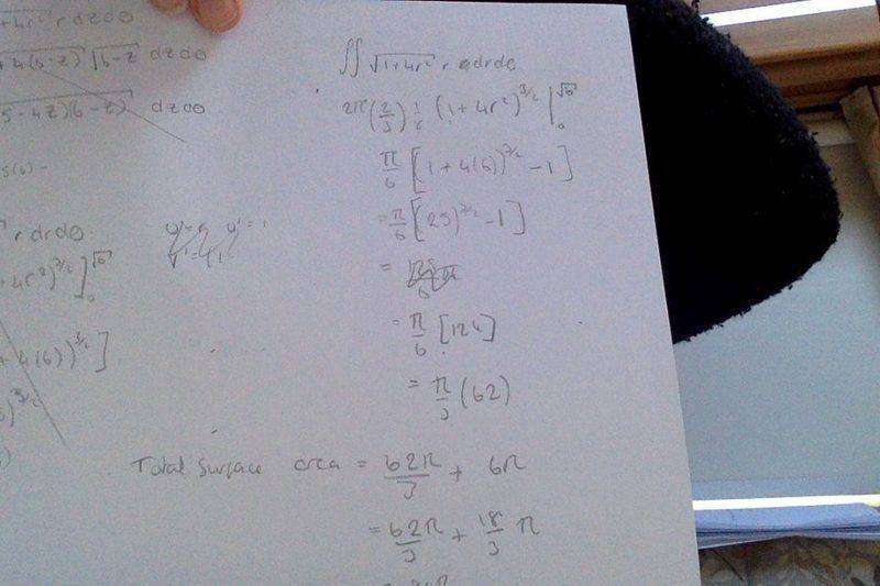

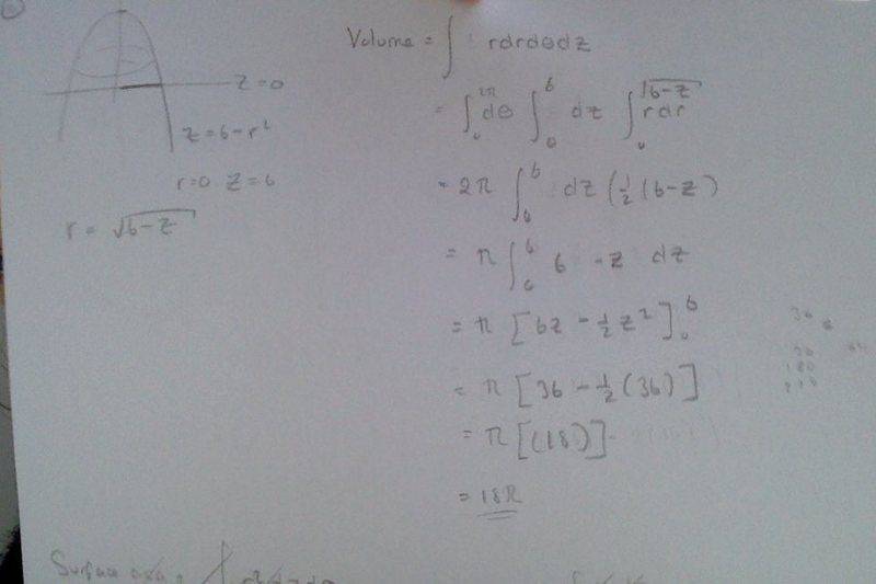

A volume is enclosed by the plane z = 0 and the inverted paraboloid, z = 6 − r2 (expressed in cylindrical coordinates). Find the volume and its surface area.
Hence, using a suitable linear transformation, find the volume of the region enclosed between the surfaces z = ax^2 +by^2 and z = 6−cx^2 −dy^2 where a, b, c and d are positive constants
below
So I've managed to do the first part (Photo of my working will be below), but am now struggling to calculate the volume between the two paraboloids. I thought of one possible parameterisation in which u^2=b/a x^2 and v^2=d/c x^2 so that I transform the two elliptical paraboloids into regular ones, but this would mean I have a 4-dimentional coordinate system, which is obviously not correct. Its mainly the parameterisation I'm struggling with

My working- Part 2

My working- Part 1

I was thinking- maybe I could subtract them and let u=sqrt(a+c)x, v= sqrt(b+d) y ? I couldn't make it work- but is that along the right lines? Many thanks
