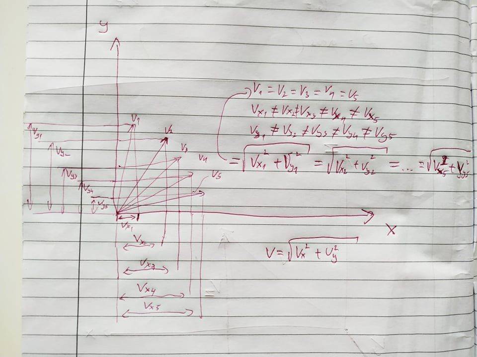

Ok I will try to expain it again. The motion is two (actually three dimensional, but for simplicity I am keeping it to 2 for now). I have x and y equations, these are the first equations that I wrote in my post, the second x, y equations I've taken from the 1D constant acceleration equations, but without acceleration.
The goal is to maintain a constant speed throughout the whole trajectory, let's say that this is 0.5 m/s.
Now if the motion is along the x-axis only or along the y-axis only, that's simple, but with the equations that I have, the motion is along both axes and that's a spiral. So Vx and Vy are different at any given moment in time, but they should always be equal to a total speed of 0.5m/s. I need to find these ratios, I need to output the graphs of Vx and Vy versus t, that's my end goal. So V versus t should be a constant, 0.5 at any given moment in time, but Vx and Vy are changing, they always end up at V = 0.5 but the ratio changes between them would change.

Im sorry, either I don't understand you, or you don't understand me.
Lets say we have a vector V that is the our desired speed of the point when it moves through the given trajectory (regardless of what the trajectory is). This vector has 2 components, Vx and Vy. There are infinite amount of combinations between Vx and Vy that will always give the desired length of the vector V (the length of that vector is our desired speed). I need to find exactly what these combinations are for my trajectory (or any other trajectory), such that, when we use these combinations to calculate the length of V, its always 0.5
I have attached an image to this post, I hope that this clarifies what I mean. I need to find vx and vy such that they always make the same v vector, as you can see, the vector always has the same length, but vx and vy can change in different moments of time
You give the position coordinates as ##x=x_0+ct\cos(\omega t)## and ##y=y_0+ct\sin(\omega t)##, where c and ω are constants.
That leads to ##\dot x= c\sin(\omega t)+ct\omega\cos(\omega t)## and ##\dot y= c\cos(\omega t)-ct\omega\sin(\omega t)##.
Hence ##v^2=c^2 +c^2t^2\omega^2##.
How is that going to be constant?
