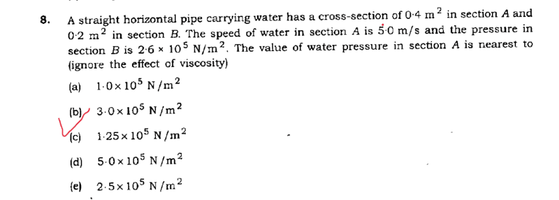

Calculating water pressure using in a horizontal pipe
Applying Bernoulli principle,
## p_a + \frac 1 2 \rho gh_a + \frac 1 2 \rho v_a^2 = p_b + \frac 1 2 \rho gh_b + \frac 1 2 \rho v_b^2 ##
## h_a = h_b, v_b = \frac { A_a v_a}{A_b} ##
Substituting the values gives, ## p_a = 3 * 10^5 ~ N\m^2 ## .
Is this correct?
Your ##\rho g h## terms aren't written correctly. But this didn't affect your answer, which looks correct to m.
##\rho g h## terms correspond to potential energies, the factor ½ should not be there. Right?
Right.
Likes Pushoam
Thanks.
