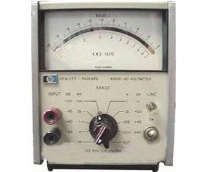

In all those years before we had digital, we had lots of AC voltmeters. For exampled the one below labeled RMS volts.
Or this cheap one.
http://www.allmobilerepaircourse.com/wp-content/uploads/2014/12/10.jpg
I suppose they could be thermal. If the thermal element was small enough, response would be fast. But were they not more likely done using the circuit below and a suitably fudged scale?
But you stated that the system "inherently" measures RMScurrent. It doesn't. It measures the Mean modulus of the current. The scale on those meters would have been calibrated to indicate the probable value of RMS on the assumption of a sinusoidal waveform. If you look at the waveform of the Mains Voltage, it is seldom a very good sine wave so an 'old fashioned' analogue meter would give an inaccurate result even for a simple case like that.
Reading what is written on the front of the meter is not enough. You need to read the spec sheet and the caveats about operating conditions if you want to be sure of the accuracy.
You're right. Strike inherently.
